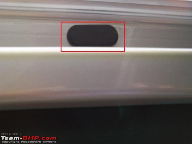

After reading your post I checked all my doors and found that many of those rubber bushes are missing. I didnt even realize till now that those exist and have fallen off. Are these not available as spare in TASS?
How did you close them with rubber solution? Can you explain pls? It will help me in fixing my Safari as well please:
Originally Posted by tsk1979 (Post 1369179)
Can somebody post a picture of the same?
This is how it looks just above the window from inside the door. They are present on each door including the rear one.
The Tata Safari 2.2L Technical / Problems Thread-srg_0127.jpg
Remove them, use the rubber solution and spread it across the inner surface and around the rim only.
The Tata Safari 2.2L Technical / Problems Thread-fb_0126.jpg
The Tata Safari 2.2L Technical / Problems Thread-rgs.jpg
Above is just a depiction on how it would look from the inside, but a lot thinner.
Wait for 5-10 min for the glue to dry and snap them back in.

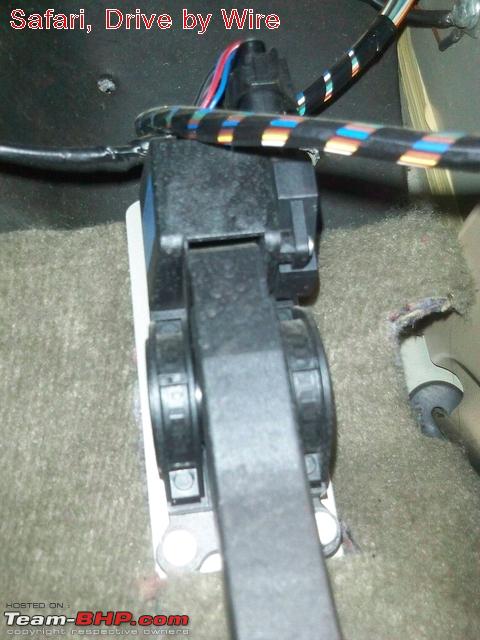

This is how a FBY looks like for Safari, you can notice the sensor below the word "Wire" in the picture.

Originally Posted by raj_5004 (Post 1369871)
many modern cars have this. all cars having cruise control must compulsarily have this.
its called the electronic throttle control & i have heard it is derived from the drive by wire system used in airplanes.
advantages are smoother & quicker throttle response, efficient use of fuel & its maintainence free.
in the same category, the innova & scorpio has this.
thanks, that was good info and new tech stuff learnt. :thumbs up
