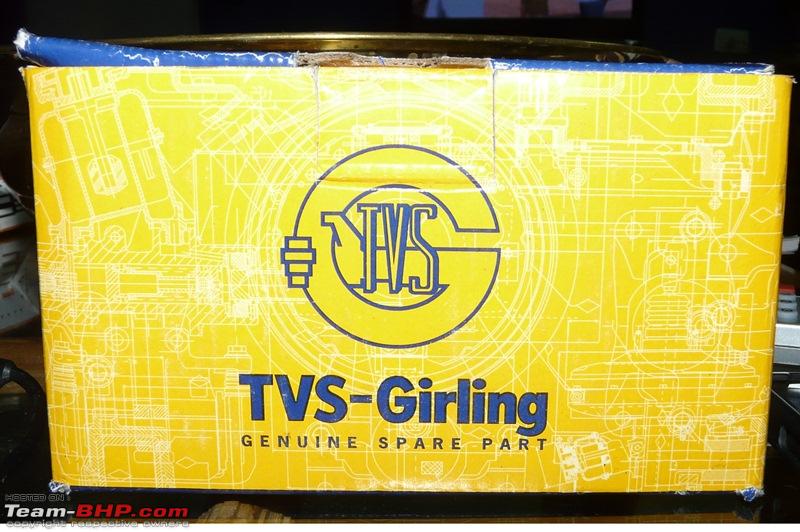

Originally Posted by LionX (Post 2173488)
@4x4addict, yes I am getting those from a trusted shop and thank you for the concern :thumbs up.
Please find the pics below, kindly let me know if you find any difference from the OEM.
Attachment 468280
Attachment 468281
Attachment 468282
Attachment 468278
If this is true, SAFARI is no more heavy on maintenance.:D
Just Purchased the same Brake Pads (TVS Girling - Set of 4) for Rs. 1080/- from Ludhiana.
The Genuineness of the same is confirmed - since got the Dealer's reference from Brakes India Ltd Office at Gurgaon.
Shall get them installed tomorrow
