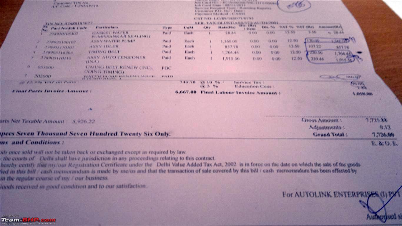

Update :
My safari went for the repair today morning. All work done. Will get the delivery tomorrow morning.
Working done : Replaced water pump, timing belt , idler, tensioner.
As of now as per SA, all are covered except tensioner. Can somebody update the same. IMO even tensioner should be covered under EW.
here is the pic of parts changed.
The Tata Safari 2.2L Technical / Problems Thread-081120111572.jpg

Originally Posted by v&v View Post
Update :
Attachment 839285
Yes, its covered. From the tata motors website
Tata Motors Customer Care :: Must Know
Engine: Cylinder head and head gasket. oil pump and drive. crankshaft and related bearing and seals. flywheel and ring gear. timing gears. belts and chains. camshaft and related bearing and seals. cam follower. valves (excluding burnt and pitted valves) valve gear. pistons. connecting rod. gudgeon pin. distributor drive. inlet and exhaust manifolds. internal oil seals. bore / liner. turbocharger. inter cooler units where factory fitted. variable geometry turbocharger .EGR cooler .Cam box . Autotensioner. Dual mass flywhee
Do not let them cheat you
tsk1979 is offline   (1) Thanks
TSK i saw this but it gets updated as per the new agreement. Is this applicable for all customer or the agreement booklet which i have signed is valid. That booklet does not have this written. But yes there is a word "TIMING GEAR, BELTS & CHAINS".
IMO this statement should include Tensioner too.
Anyway will mention about the website to SA. Also i think coolant too will be bill to me.
Write to tata motors giving link to this page(customer id), and it will be sorted out.

Got my beast back. Had to pay Rs 1098 for Idler & gasket.
Every thing presently seems OK.
Attachment 839742
Lucky you, when they changed my timing belt, had to pay for the tensioner too. total cost around 3.5k. I never knew that you need to push for getting things done under warranty...sad sad
