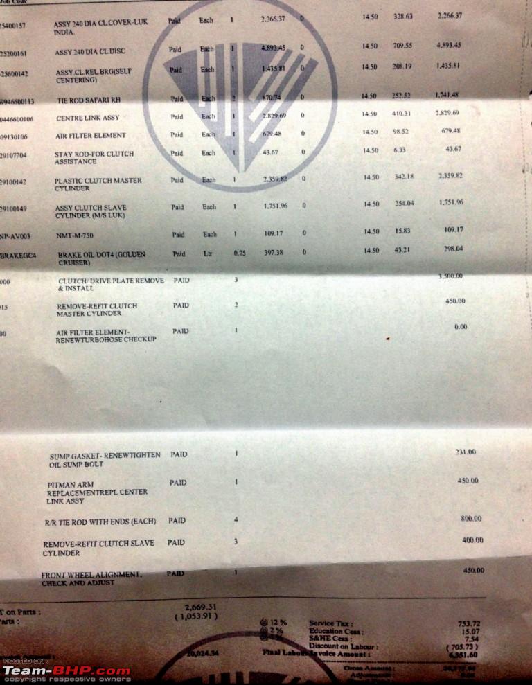

Gave my Safari to Prerana Motors as the clutch seemed at end of life, the following parts had to be changed :
1. Clutch cover assembly
2. Clutch Disc
3. Releaser bearing assembly
Then I had found out that the tie rod end was also worn out, so the following got replaced:
4. Tie rod set
5.Centre Link assembly
After replacing the clutch kit, it was found that there was a grinding noise wehn the pedal was depressed, turned out that the master and Slave cylinder of the clutch also had to be replaced, so:
6. Stay rod for clutch assistance
7. Plastic clutch master cylinder
8. Clutch Slave cylinder assembly
9. Clutch fluid
10. Air filter element (regular maintenance)
The total bill came to some 28k plus, after discounts the final bill was Rs. 26375/- inclusive of labour charges for the work above. This is the single biggest amount I've spent on the Safari in 3.5 yrs of ownership as none of the parts were covered under extended warranty. Are these expenses indicative of things to come in the future?
Here is a scan of the bill with parts description:
The Tata Safari 2.2L Technical / Problems Thread-preranabill-1280x768.jpg

Luke I think we need to find an aftermarket garage in Bangalore which can take suspension / clutch jobs on Safari. Safari parts are available at around 50% of MRP outside.
BTW : In newer version of 2.2 Dicor they have almunium master and slave cylinders and clutch operates quite soft compared to older ones.
I am thinking of going for almunium one whenever the need arrives in future.
T.A.S.S has habit of advising clutch overhaul , I complained about extra hard clutch at 42K and they told clutch is gone there was no slippage etc so I went to another garage and just got the clutch fluid replaced and it is working fine for last 5K KM.

I just got some of the work done from my local mechanic and the cost was 50%. As a thumb rule, for whatever is non critical and not inside of engine, use local mechanic. For e.g. clutch cover+Disc was for Rs 5000. Please don't get alarmed with the costs. Its a big car, and things like clutch and suspension needs work around 70-90k k.m. As you car is approaching 4 yrs, next may be the replacement of the engine belts (and the wheel bearings). Your car should be then good for next 3.5 to 4 yrs
we need to find a workshop which can handle safari's comfortably, T.A.S.S has a habit of replacing parts unnecessary. For me, if it aint broke dont fix it (dont replace parts till you can see/feel some problem yourself).

Luke, the master and the slave cylinders are covered under extended warranty. The clutch and the related parts are also mentioned to be under EW, but after 35-40K kms they don't honour it and cite wear'n'tear.
By the time the EW on my truck finished, i have gotten 2 slave cylinders and 1 master cylinder (even though the master cylinder was working properly, got it to change when it actually fails) replaced FOC.
Take the A.S.S to task, raise some noise, write a mail or two, should help getting at least the cylinder covered.
Thanks Trance_Nut, I have raised it with the A.S.S and they have promised to have a re look.
Attachment 1008008
You have been cheated.
Clutch slave cylinder and master cylinder are covered under extended warranty. Only the pressure and clutch plates are not if worn
did you inspect the clutch and pressure plates yourself? If they are not worn out, they are covered under extended warranty
tsk1979 is offline   (1) Thanks

Part No's of the parts used, and charges as per invoice (Luky, I see a difference in the charges made for you, for a few of the common items. Maybe they are Mk-II specific. Please do verify with your TASS):
