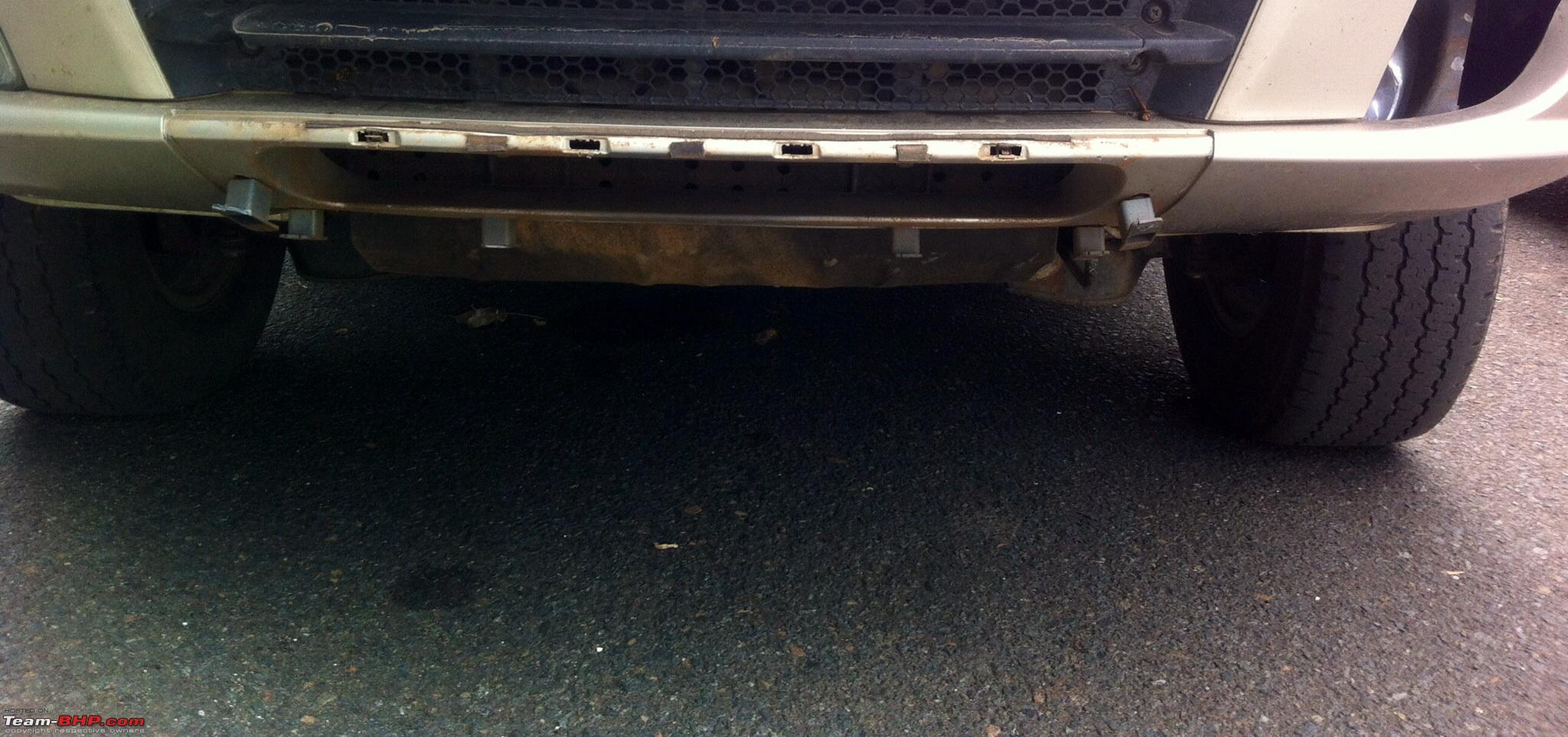

Hi guys
Need help on something. Whole driving on highway, a dog suddenly came in front of vehicle. Inspite of best attempt to steer away, it got hit. Due to which the chrome plate on front bumper underside broke away. The bumper is alright. The TASS says that they will replace whole bumper. Is it possible to source just the plate?
Thanks

Originally Posted by sheelz View Post
Hi guys
.... a dog suddenly came in front of vehicle...chrome plate on front bumper underside broke away. The bumper is alright. The TASS says that they will replace whole bumper. Is it possible to source just the plate? ...
Yes very much possible. I had done it after a very similar incident couple of years back. The chrome garnish + the gray plate attachment (VX trim) comes as a separate assembly for some ~2.5K or so and whole bumper (w/o painting) is about ~4.2k. If you want the part# I have to hunt for it. But, insist on TASS to get just this garnish.
-BJ

Thanks BJ
Tass here has told me that it doesn't come as a separate part. Could you tell me from where did you get it? Or part no etc?
Thanks
-BJ
Thanks for the reply
Spoke to Tass guys. They are saying that they checked their catalogue and it doesn't exist. Could you please tell me where to procure it? Thanks
Hi Sheelz.
Check 99rpm.com for safari,s bumper. You will get the part number. Unfortunately they have stopped providing tata parts, else you could have ordered it online. Wait for few months till they are online or drop a mail to their sales team if they can provide.
Regards
Could you please tell me where to procure it....
It was done at local TASS in Hadapsar- Srinivas Auto. Bill attached. Not sure the part number is correct as it looks like a generic labor category.
The Tata Safari 2.2L Technical / Problems Thread-imag0589_1_1.jpg
-BJ
