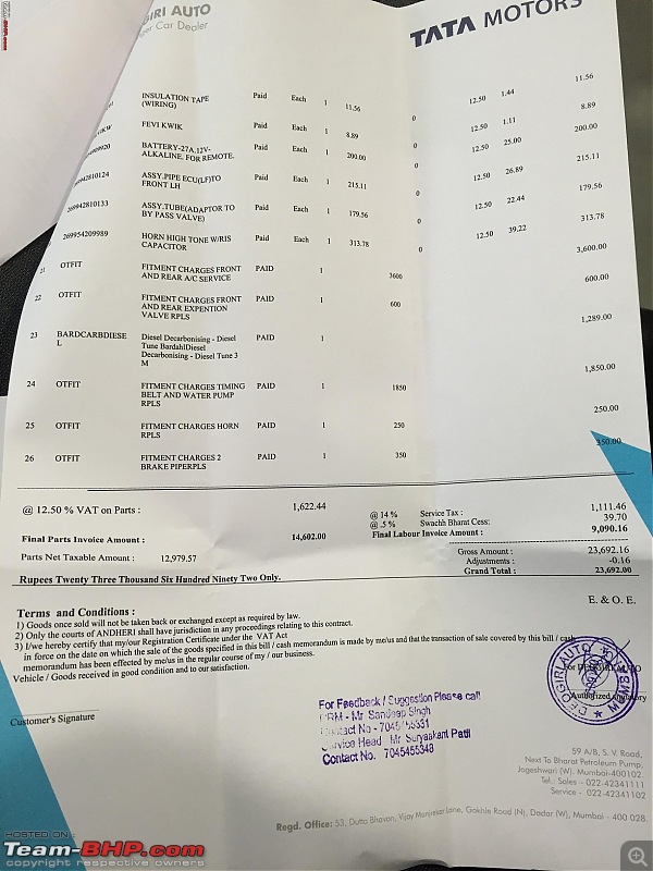

Hello
Thank you for all your help
Finally got the truck back
Had ac work done plus timing belt and few other work. He says there is some knock while running maybe injector told me to give a run and inform
I am attaching my job card for reference and comment for the work done
The Tata Safari 2.2L Technical / Problems Thread-2.jpeg
Forgot to attach first page of the job card
The Tata Safari 2.2L Technical / Problems Thread-1.jpeg
Last edited by Gannu_1 : 26th December 2015 at 08:44. Reason: Back to back posts merged, images rotated and uploaded.

I got my car back and most work done. However i see a small vibration sound as the rpm of the car is increased. This noise was not there before I gave to TASS. Its something different. The TASS informed one injector is little bit choked but this noise is not that of the injector. Its l a noise like when air rushes pass a loose aluminium foil. I have made a small recording and hope experts can inform if this is due to silencer or some loose fitting. I got my timing belt and water pump changed FYI
How long is the shell life of an unopened engine oil can. I have 500ml Castrol CH4 oil manufacture date is 2010.
Thanks

Originally Posted by lodhra View Post
hello
I have two questions
I got my car back and most work done. However i see a small vibration sound as the rpm of the car is increased. This noise was not there before I gave to TASS. Its something different. ... Its l a noise like when air rushes pass a loose aluminium foil. I have made a small recording and hope experts can inform if this is due to silencer or some loose fitting. I got my timing belt and water pump changed FYI
I can't make out the odd sound. May be the engine sound had drowned out the noise you are referring to.
As you have just half a liter of engine oil, you can use this oil for topping up - though Safari Dicor rarely needs topping up.
Prowler is offline   (1) Thanks
hello
Thanks
The sound seems like some loose nut or piston knock, what happens when you accelerate does it increase in the same proportions ?
dadu is offline   (1) Thanks
Old 30th December 2015, 19:18   #6131
Posts: 197
Thanked: 41 Times
Re: The Tata Safari 2.2L Technical / Problems Thread
@dadu
The noise increases its harshness as one accelerates or rpm increase . It goes of when rpm is steady only on acceleration it is audible
lodhra is offline
