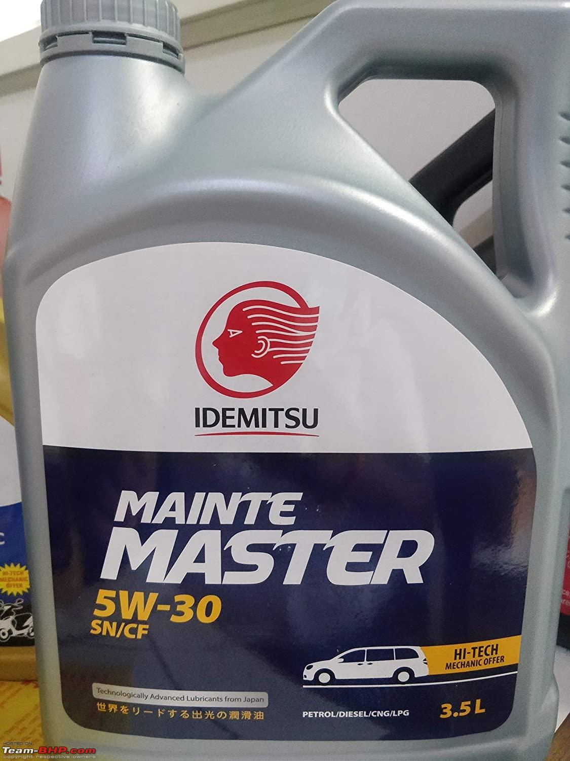

What's the best recommendation for engine oil for a Dzire Tour taxi diesel. It's 2 year old taxi with around 30K kms on it.
Ok to go for fully synthetic but not super premium as running cost will go up.
I was looking at few options but confused what works best for taxi where mileage and wear protection is more important.
A two year old taxi with just 30k on it? Some taxis will rack up that much in a month. Use any engine oil you like but change the oil every 10k - or even earlier in cases where you're using semi synthetic.
Stock up on Shell Helix Taxi 5w30 semi synthetic in fact, it is an excellent oil for that kind of usage pattern, but shell may be phasing it out so just stock up on it and leave it in a cool, dark place. Or full synthetic - Shell HX8, again, being phased out, and replaced with some 0w30 / 0w40 full synthetic oils that may not be the right thing for sustained taxi use.

Haha yeah I think it maybe more kms though. My driver got the cab before the pandemic and then he couldnt use it for almost a year.
I saw the 5w30 Shell Helix Taxi and was going to ask for that to you.
Right now he is using this oil and is unhappy as diesel clatter has gone up and doesnt feel refined:

Sure get the taxi - it will be a decent oil even for your ecosport tell you the truth. So will the Mobil 3000 x1, that way you can save on oil changes too as left over oil after filling the ecosport can be used in the cab.
The mobil is a 3.5 litre can so you need to buy 2 cans and use a tiny amount from the second can, as things stand. But a 3.1 litre capacity for Dzire diesel means you can happily fill two cars and use up the second can. Won't cost you extra, and you don't need to keep the second can as a leftover till it is time to change your ecosport again.
