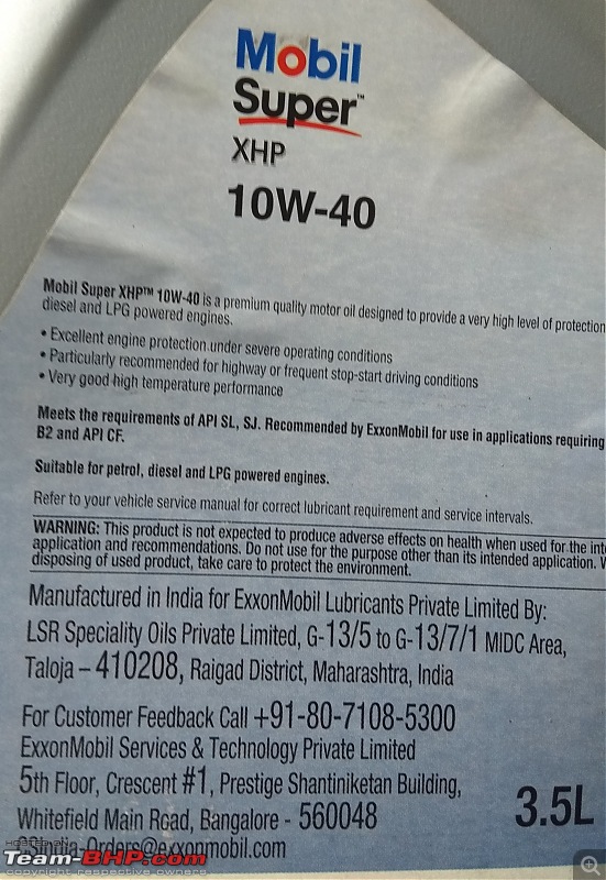

Resulted, in being able to get this oil -
This one is rated for usage in petrol, diesel as well as LPG engines. As against the requirement of SG it is higher rated as SL.
Got the engine oil changed a week ago, and have driven 500+ kms so far.
Don't remember to have used Mobil till date - or may be once? Seems to be better in comparison of earlier 15w40 as far gear shifts are concerned, only the first gear is slightly hard, others shift better. Engine is comparatively silent (could be because I got the timing belt and the tensioner bearing changed).
Oil was close to year old and cost me Rs. 1,600/- (almost double of the 3 litre 15w40 of ENI that I posted earlier).
Guess the diesel cars requiring 10w40 oil can opt for this....

Originally Posted by vrprabhu (Post 5206319)
API CF was introduced in 1994 for Off-road, indirect -injected diesel engines (aka Pre-combustion Chamber diesel engines).
This CF was NOT intended for then prevailing Off-road (or on-road) direct-injection diesel engines where CF-4 spec was recommended.
Imho, the above CF Mobil oil is surely not intended for modern 2019 Hyundai diesels like i20, which is a direct-injection diesel engine, albeit for on-road use.
Hyundai recommends ACEA B4 for diesel engines without DPF. Mine is a 2019 diesel i20, hence it is a BS4 engine without DPF. And, the manual says if recommended grade is not available then use engine oil above API CH4.
Hence a 1994-intro CF oil surely does not comply with CH4 introduced in 1998.
Not suggesting this Mobil CF would destroy a 2019 Hyundai diesel engine in immediate term though.
