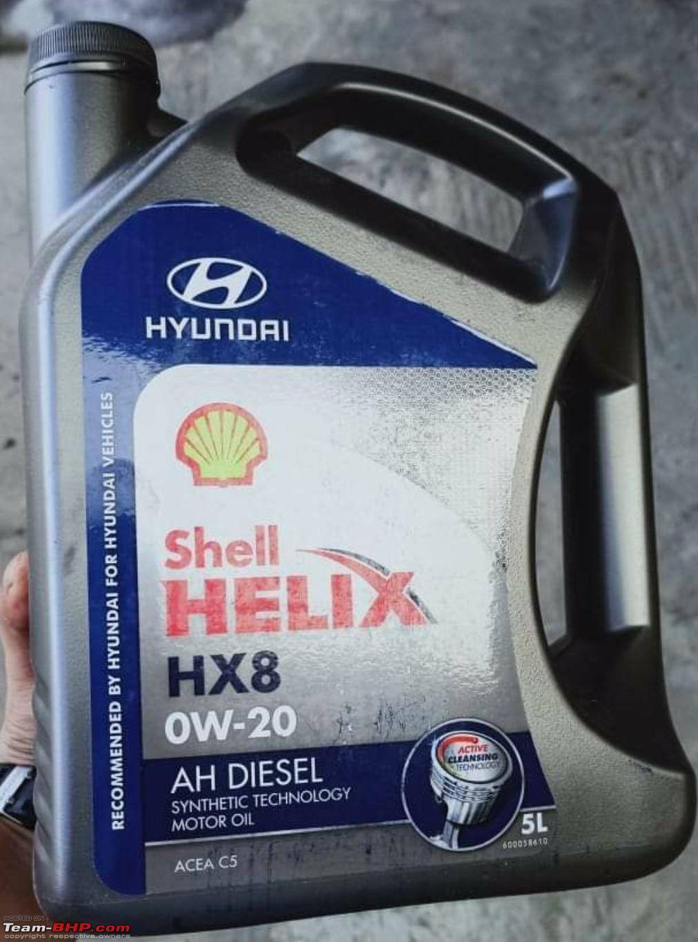

Hyundai is ok with either of ACEA C5 or C3 or C2. Need not be specifically C5. Not sure how A5 spec will fit in here, especially with Creta 2020 having DPF.
Someone in Creta fb group had shared a photo of Shell Helix HX8 0W-20 C5 with 'recommended by Hyundai' label. States MRP as 1775, not sure if its fully-synthetic/semi/mineral oil. But I have not been able to find the same online, Shell India website does not even list Creta 1.5D engine and also has no recommendations for Seltos.
Below is screenshot of the same.
After paying 4500 for synthetic oil, I would be disappointed if they passed on a non-recommended engine oil grade.

This oil is not fully synthetic. It is made with synthetic techonology and that means semi synthetic.

AH is a grade of shell that is made only for OEMs and is not sold on the open market to my knowledge.
0w20 is a synthetic spec not mineral, probably a group 3 (cheaper) synthetic.
You want a nice costly and high quality c5 then this is the only one on the market.
Mobil 1 ESP X2 0W20 Advanced Full Synthetic Engine Oil (1L) https://www.amazon.in/dp/B01M27YIJW/...M52MVPX5H4CP1Z

Semi synthetic aka synblend, mineral and synthetic mixed. Full synthetic group 3 is what most oem oils and other cheaper oils on the market are.
Easier to refer to group 1,2,3, 4
