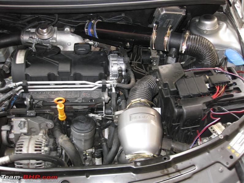

Could you post a pic of the engine bay, may be of help to understand how it could be done.
Will try getting a picture in soon.

I definitely feel its got to be your EGR valve and the intake manifold that is choked. Once it's cleaned you would see the difference it makes in power, mileage and smoke.
Here is one site which has all the details on the VW diesel cars. Just to let you know how bad it can get with the carbon.
Cleaning the intake manifold of carbon build up Difficulty
When I got my EGR cleaned the pick up was way better than even compared to the 1st few days of getting the remap done which i got it done at 5000kms. Also since my car is yet under warranty it was taken care without me getting charged for it.
I am using the Green Storm Filter but with a custom intake and would vouch on it, it has made hell of a difference. Not faced any issue with it. It's just not about the size of the filter, its also about the velocity of air, which plays a very important role in getting better low end and top end grunt.
If you can post the pic of engine bay will be easier to decide as to what option you have.
Here are the pics (just for illustration purpose) of the choked EGR valve and my custom intake. Will be redoing the intake with shorten length.
Pete'd Viva CRDi: Smoking All !!!-egr-valce.jpg
Pete'd Viva CRDi: Smoking All !!!-.jpg
