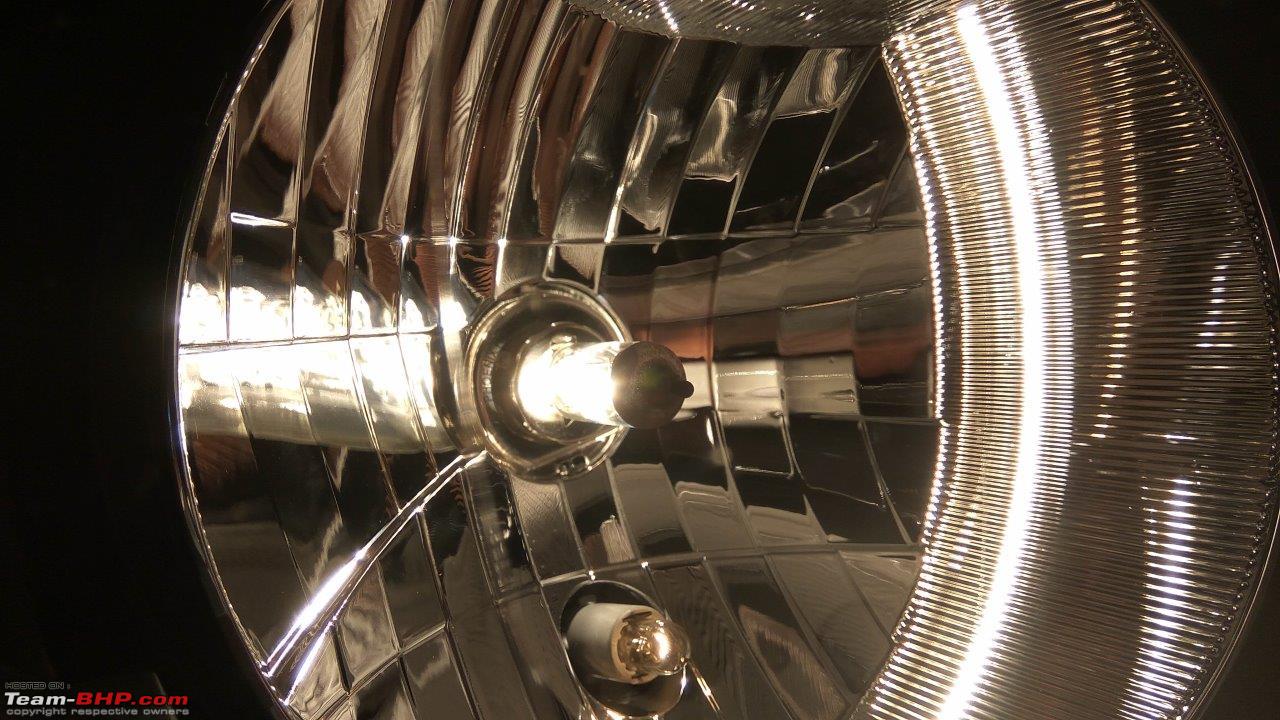

Let me know if below images can be of any substance :-
Stock Fog Lamp :-
Headlight (low beam) :-
Headlight (high beam) :-
EDIT :- Just saw one video and there its mentioned on the back of the headlight that its of H4, 60/55W. So one confusion resolved.

Goodness! That surely is irritating. For the details of the fog lamp, the best way would be to open the fog lamp casing from behind and check the bulb specs. Should not be a difficult DIY. Though from the picture is looks like an H8.
