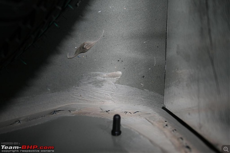

So ppl here think that metal is brittle like concrete and will have "crack" marks even on low impacts?
The cracks which is shown is not possible to get in a small accident.
Looks more like a "congenital defect" - wherein proper welding was not done.

Hey Anil, I checked mine only this morning and guess what, Mine looks cracked too. I'll post the pictures tomorrow. I have another question for the other Figo owners. The rear Hatch the panel gaps are 'uneven'. The Gap on the right is more than it is on the left. and the Glass area (over the parcel tray) behind the rear window, The gap is more on the left than it is on the right!! Do not have the pictures of it. Will post it, along with the 'crack pictures' tomorrow.
I have emailed Ford the pictures, waiting for a response from them.

Mathew, sorry to say but I suspect some foul play from the dealer, improperly painted door and now inconsistent gaps!
The sealant can crack for small impacts too. I got mine repaired will post my pics soon!

Here what is to be noted is that all figos have such sealant applied on a joint which appears as patch. In the hit the joint, perhaps press fit got away and the gap is seen as in the photo.
Others by seing the normal patch also getting perhaps, confused.
In no way such wide gap is normal in a production car.

here's the picture of the cracked seal inside the spare wheel compartment. The other pictures are the panel gap on the glass area behind the rear windows. If you see there's almost no gap on the right, While on the left glass the key can go in.
I also called ford customer care, The rep said, someone will give me a call back before the end of today.

Hey Anil, sorry for the late update. I was at the Ford showroom (MPL) on Saturday to take delivery of my Brother's Figo.I happend to talk to the sales manager there, I showed him the flaws in the car. He told me that the Cracked seal is common in all Figos and I actually checked on a few and they all had it.
For the Inconsistent panel gap on the Hatch, He said it's an alignment problem and it can be fixed. First person to actually tell me what the real problem is!!
The inconsistent Gap on the glass area behind the rear window was there in almost all of the cars they had on display.
The paint flaw was there on my brother's car as well (Just like mine) I showed it to the Sales rep at the time of the delivery, he said they'll fix that one too. I checked a couple of other cars there, They did not have though.
On Monday, I happend to go to another branch of (MPL) Ford to get the fog lamps fixed in my brother car. They had a few Figos there ready for delivery, I was able to find the same paint flaw (on the hatch door) on atleast two cars.
It looks like the QA dept is on Vacation at the Ford plant . There's no point in emailing the customer service and the president's desk. I'm looking for an email ID for someone at Ford who would actually take these things seriously. Not as a complaint, I just want to bring it to their attention, So they can fix it.

Sorry for the late reply. Here is my Figos boot.
mathew1105
did anyone from ford call you back?

I think this is a defect.
But captain, I can see cracks on your pics too, is that a recent development?

It wasn't there or maybe i didn't take a look properly :(
Yesterday I took the pictures and to my horror I found these cracks!
Yup seems like very poor QC!
Those inconsistent gaps in mathew1105 car reminds me of the old temp trucks!
I don't think our figos will last more than 3-4 years.
