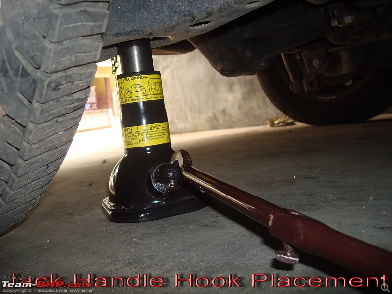

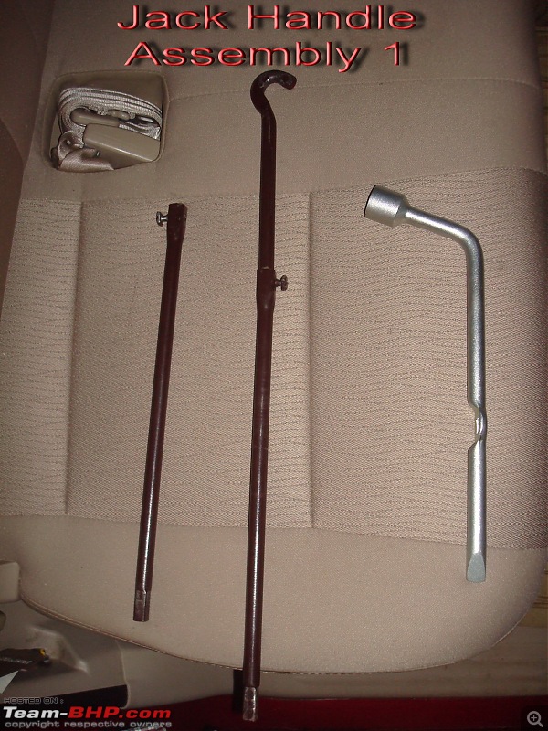

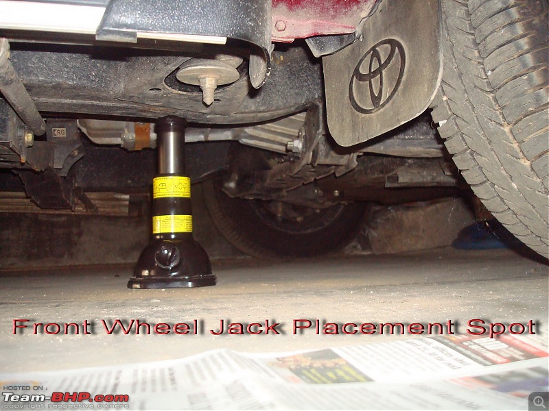

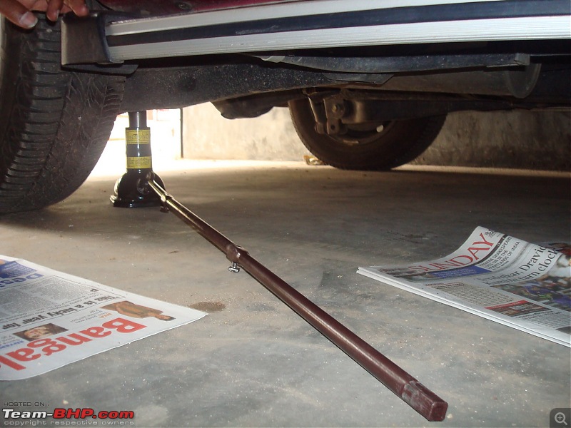

Jack Positioning in Innova Pictures
Thought of helping out iraghava with some pictures Jack placement areas of Innova, will post the removal of spare next.
In the rear tyre placement, would the vertical jack be able to be placed there if that side tyre is flat?
trrk is offline
Old 1st June 2009, 15:09   #75
Join Date: Feb 2008
Posts: 57
Thanked: 16 Times
Originally Posted by trrk View Post
Hi,
Hi,
The Jack shown is a Bottle Jack that comes with a Innova, however you must be enquiring regarding a Scissor Jack as shown in the image below which can be placed in front of the hollow area, along the length of that part of the chassis (where there are two holes next to each other).
