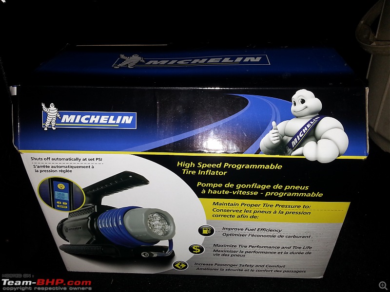

I would advice all XUV 500 owners to carry an air compressor, a one meter GI pipe, a hammer with padding. I have bought one air compressor (michelin, pic attached).
Pictorial Guide: How to change a flat tyre!-20151114_120001.jpg
My car is Dec 2013 model and the wheel has been rotated during services.
