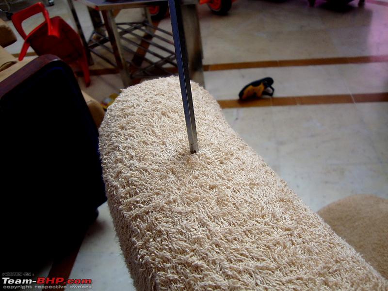

Once the covers are fixed with the elastic bands, the headrest mounts need to be taken out. Just poke the mounting hole with a screwdriver and gently pull the hole outwards and tuck it under the mount. Its a cotton towel cloth, it can be a little elastic in nature.
That's how it looks in the end.

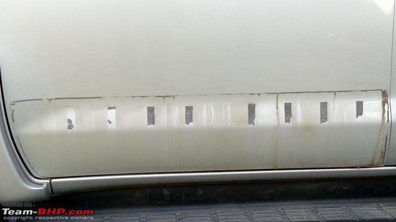

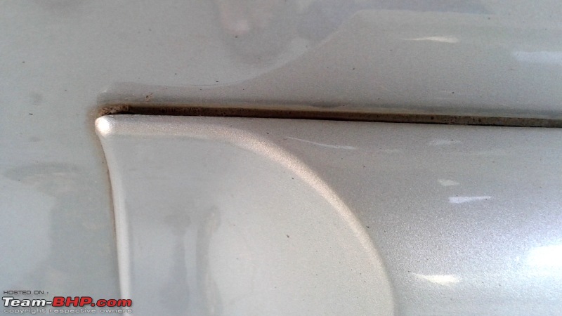

There was a long time pending DIY of fixing the cladding. It was not added proplerly from day 1. Actually - through insiders @ the showroom it came out that it was not fitted properly and was taken out and re-fitted correctly 'without' replacing the double sided tape and the same tape was used. They were asked to rectify the issue on they first servicing - was good for some days and has been worse since the last 2 months or so. Everytime I used to go on a highway, this cladding thing used to bother me a lot.
Here is the evidence that it is coming out loose
'Megalodon' - 2012 Toyota Fortuner 4x4 MT Silver Mica Metallic-20121206_113057.jpg
'Megalodon' - 2012 Toyota Fortuner 4x4 MT Silver Mica Metallic-20121206_113105.jpg
'Megalodon' - 2012 Toyota Fortuner 4x4 MT Silver Mica Metallic-20121206_113132.jpg
'Megalodon' - 2012 Toyota Fortuner 4x4 MT Silver Mica Metallic-20121206_113151.jpg
Zero effort needed to pull them out. There was approximately 30% adhesive life left in them and they came out with bare hands to reveal this.
'Megalodon' - 2012 Toyota Fortuner 4x4 MT Silver Mica Metallic-20121206_155706.jpg
'Megalodon' - 2012 Toyota Fortuner 4x4 MT Silver Mica Metallic-20121206_113117.jpg
I am not fixing them back today, will take care of the same in the next episode of Sunday Dunday. Today the other thing in pipeline is deep cleaning of the air filter.

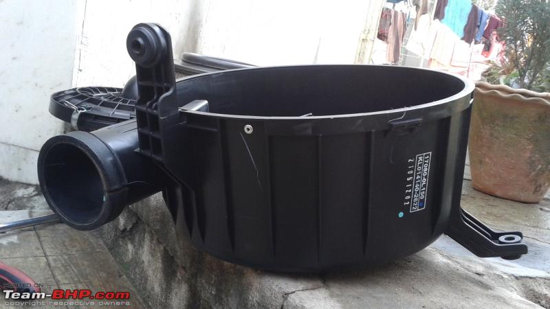

Filter Tub

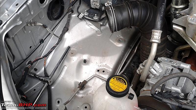

Space where the filter used to be in the engine bay
'Megalodon' - 2012 Toyota Fortuner 4x4 MT Silver Mica Metallic-20121209_084925.jpg
Filtered air intake
'Megalodon' - 2012 Toyota Fortuner 4x4 MT Silver Mica Metallic-20121209_090500.jpg

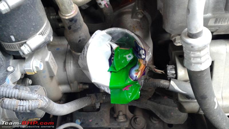

This was covered instantly so nothing can fall in by accident. VERY CRITICAL!

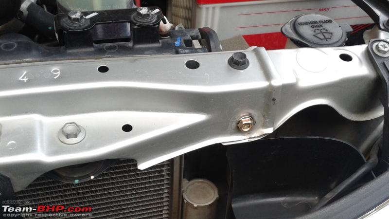

In my earlier post I had fixed Roots Vibrosonic Horns here.

Cleaned air filter Tub

However when cleaning the air filter periodically I refrain from removing the filter housing and only clean the filter element with a HP air hose. Reason being repeated removal and fixing back can cause minor gaps to develop in the plastic hoses/connectors which don't seal well irrespective of how well/hard you tighten the clamps. This could lead to the MAF Sensor to malfunction in due course of time.
Faced this once in my Scorpio and after that have been careful with the plastic parts.
Great to see the neat engine bay of 'Meg--odon' !
Also the deposits you see on the ribbed air filter housing cover are not of salt/s (not that I have tasted it to confirm !) but dust and grime which is attracted because of a silly practice being followed by the ASCs. What happens is that everytime you give the vehicle for a service and they wash the engine bay, post the wash they use a 3M cleaning & polishing liquid (white in colour) on the plastics to give it a sheen. But there are pools of this liquid left in the ribbed pockets which are not dried out by the cleaners. This liquid by nature is sticky and over a period of time attracts grime and dust leading the cover to resemble a scrap yard and there are white streaks left by the liquid - resembling salt deposits. The solution (pun unintended !) to this is to either instruct the ASC not to use the 3M liquid and just water wash the engine bay or after the liquid is used to use a HP air hose and blow dry the ribbed and other areas which collects the liquid in pools. It remains neat and clean for a long time.
