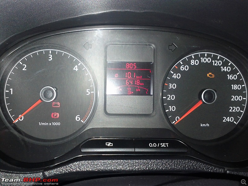

Update:
Car broke down,AGAIN!!
Just when i thought all troubles with my Polo had ended, its made a comeback with a vengeance!
We had to attend a family function, so mom and sister had taken the car along with a few of our relatives(all ladies apart from the driver) to Kadur (200 kms away from bangalore). When they were near Gubbi, driver noticed loss of pick-up,overheating and fumes from the bonnet.
He immediately pulled over, everyone alighted the car, waited for a few minutes and opened the bonnet to check what had opened. Oil level, coolant levels were all fine but the diesel pipe was broken and had caused diesel to spray over the car and leak from the wheel wells.
On careful examination, there were no rat bites anywhere and a local mechanic suspected a defective pipe. VW helpline has despatched a flat-bed from bangalore which should get there by 3 30pm or so.
Luckily the car didn't catch fire and the driver pulled over just in time. I shudder to think what would've happened had he not noticed this and responded quickly!
All is well with the family and they took a bus to Kadur.
Its been less than 10 days since my car cameback after a monsoon check-up and this happens. I'm fed up with this car!

The issue has been identified as a clip/blot near the fuel injector which has gone lose and this resulted in a diesel spray on the engine bay and other parts. My sister also mentioned she could see some diesel spray on the rear windshield, wheel wells, wires in the underbody.
It took them a few mins to rectify the issue, but diagnosis took a lot of time and i've to pay Rs. 1000 for diesel they used while diagnosing. This after the car having half-tank of fuel when it was taken on the flat-bed. The SA i'm dealing with is new and a honest chap, so my experience is slightly better when compared to before.
Guys, is there a possibility of engine damage or fuel filter damage because of this? As the diesel leaked out, the fuel:air mixture in the cylinder would've gone for a toss. Also, once the car stalled my driver and the VW guys tried to crank many times.
Is it something I should be worried about ?
