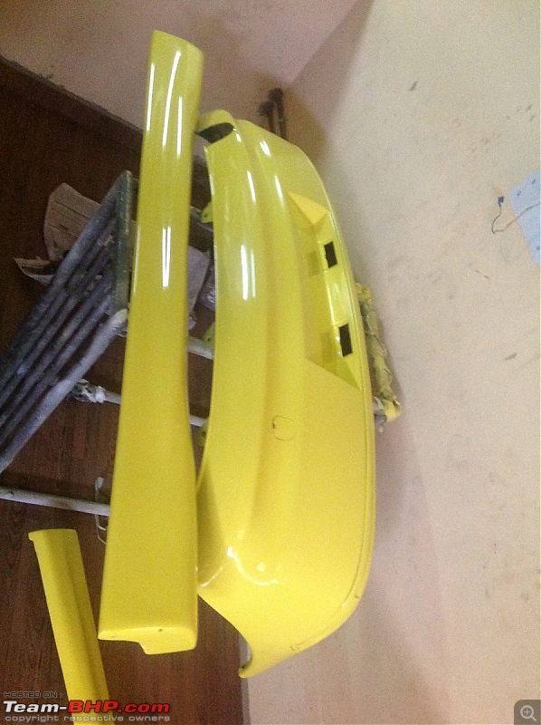

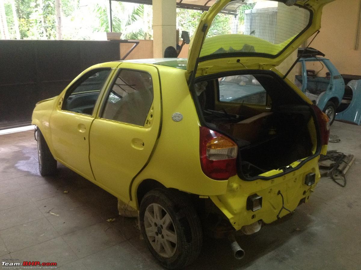

The most difficult part of the paint job is getting the decals right.
Before removing the OE decals, I had taken measurements and coordinates of the same. And also, made high quality replicas of the decals.
The side fenders and bonnet signs are easy. It's the rear hatch door which posed a problem.
The decals were stuck on after painting, but before the clear coat. The clear was applied on the decals to serve as a protective film for the same.

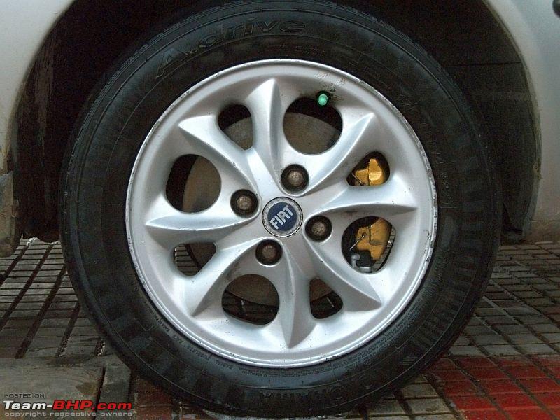

Some months before I upgraded to adventure brakes. Soon the rear set up will also changed to adventure brake set up. The brake is quite grippy and inspires lots of confidence past ton.
My quest for a hot hatch!! Palio S10 EDIT : Now Another one; the mods have begun-dscf1790.jpg
vijaycool is offline   (3) Thanks
Old 19th July 2013, 21:59   #150
Location: calicut/coimbatore
Posts: 135
Thanked: 67 Times
Re: My quest for a hot hatch!! Palio S10 EDIT : Now Another one; the mods have begun
The rotors are definitely bigger!
Did you get the set up from the authorised dealer or some other garage?
