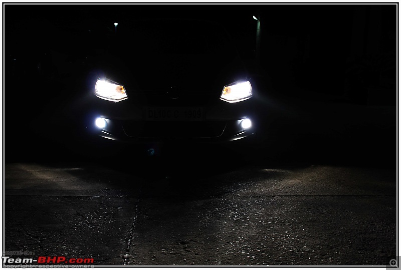

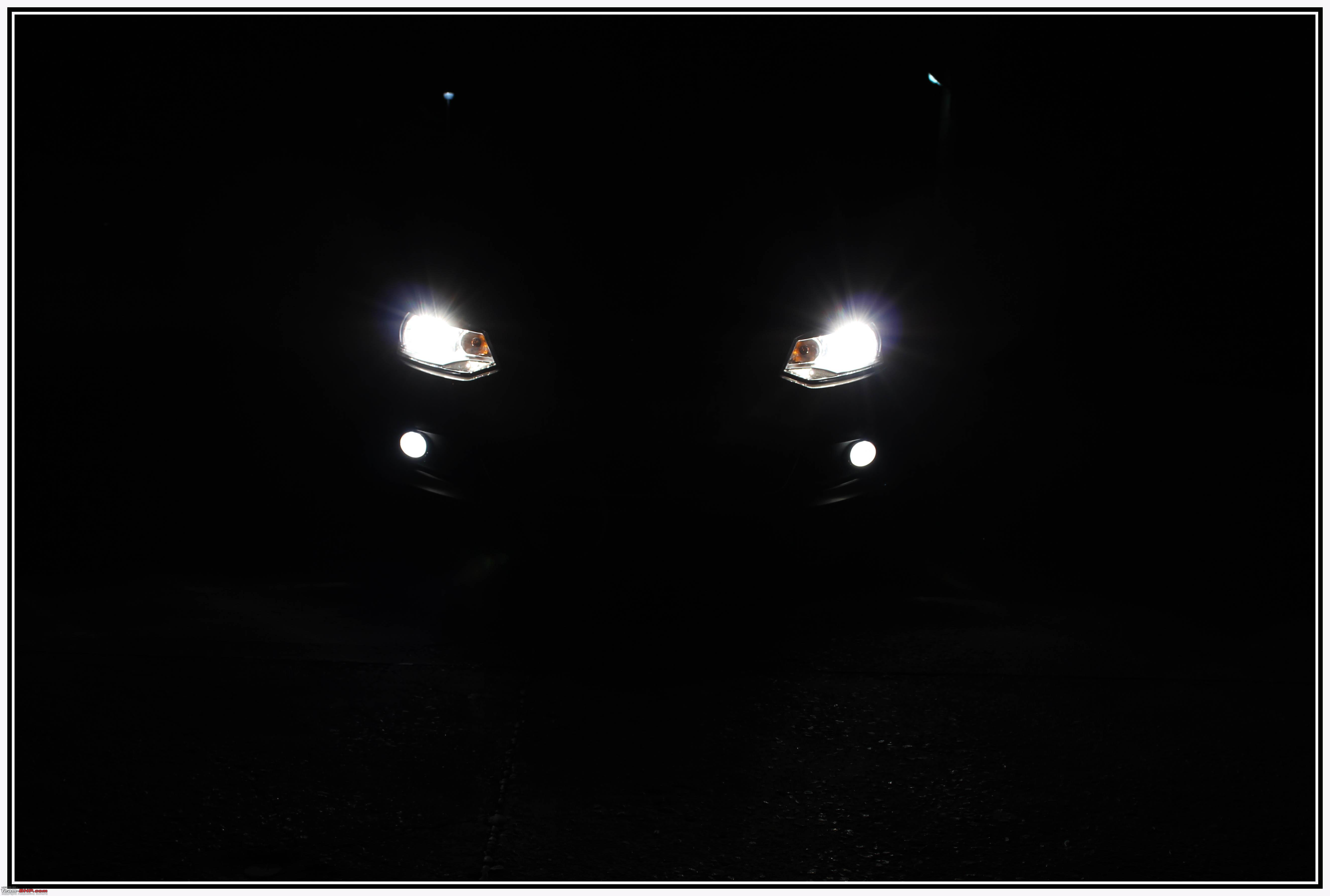

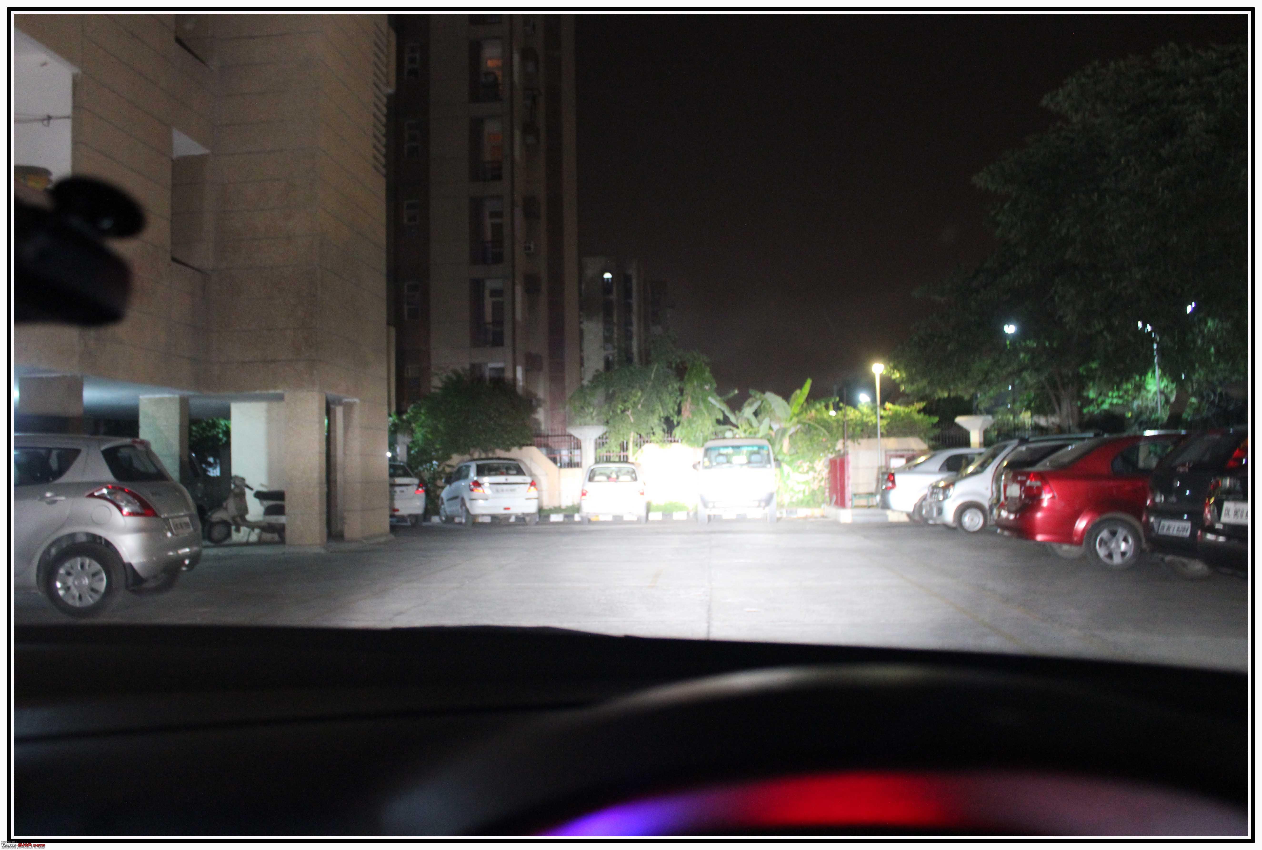

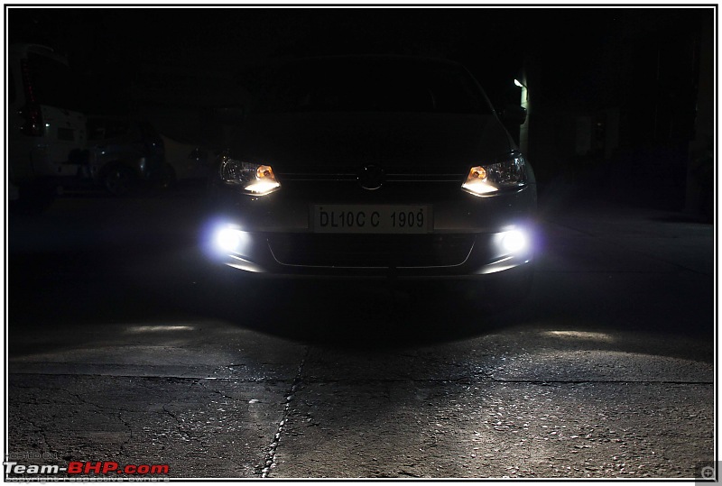

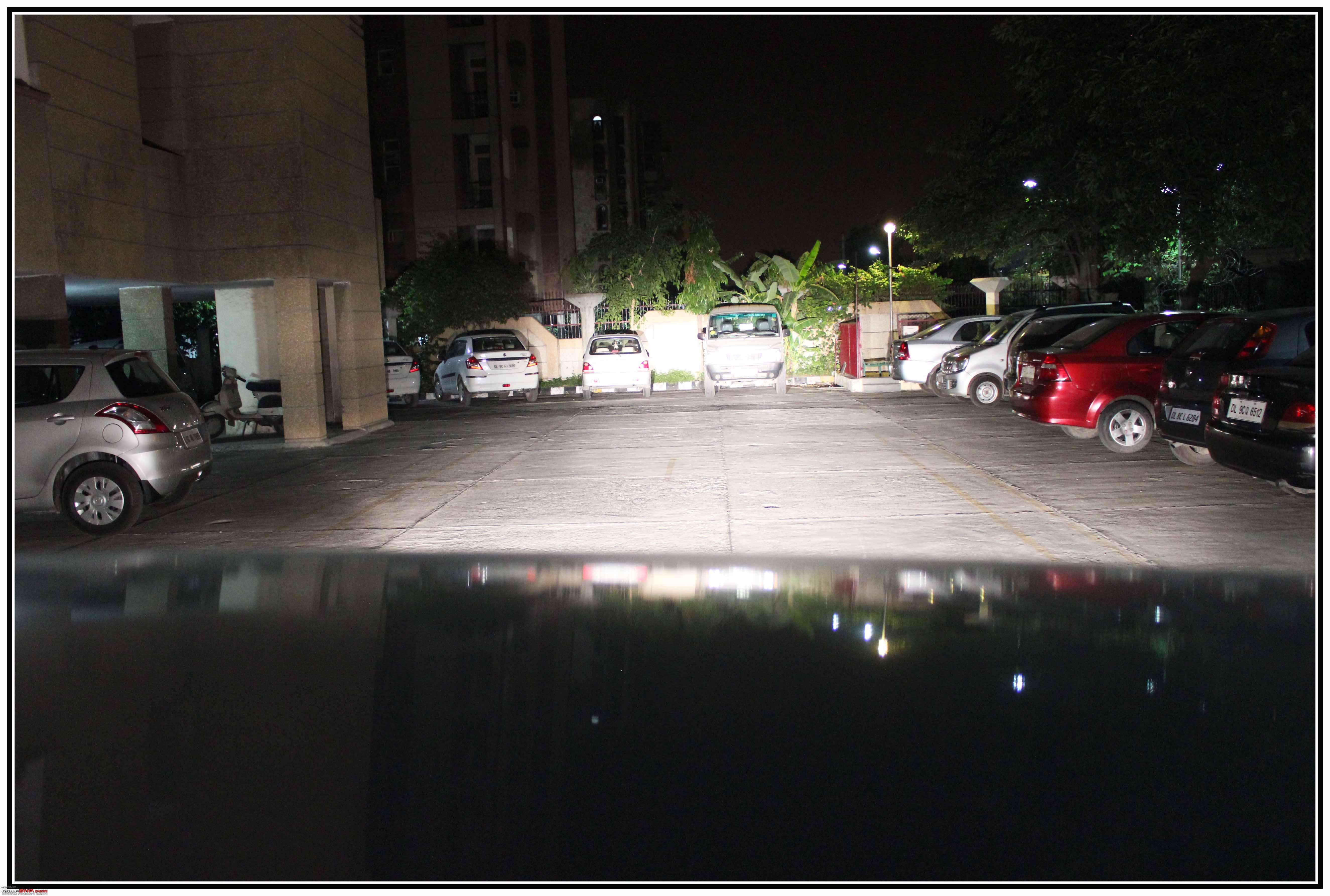

Woho, its been ages since i updated my thread, a lot has happened ever since the Vento entered my life, its been giving me immense pleasure with the wicked 250 nm of torque, zilch turbo lag and just brilliant dynamics out on the highways. I have faced some niggles (more on this later), the car has been delivering a constant 17.5 km/l in city and i just had a 600 kms trip to chandigarh and back (all 4 lane highways) and it delivered a good 19.2 km/l with ac on all the time and some spirited driving.
As i had mentioned that i was very disappointed with the headlight setup as it was just like a candle out on the highways, both (me and my friend, you guessed it right, Rapid wala ) got our upgrade done together.
Special thanks to member el lobo for his detailed post on this.
1. Philips essential vision 90/100 for Low beam
2. Philips crystal vision HB4 for fog lamps
3. Philips relay kit
4. Philips blue vision W5W for parking lamps.
The entire thing costed me around 3000 INR and the results are brilliant, the low beam is quite good but its the high beam that makes the 3000 bucks seem well spent, stupendous throw and intensity, i can drive with confidence now.

Some pictures of the light upgrade -
Low beam with fogs on - inside
High beam with fogs on
Low beam with fogs on (photo from roof)
Some random shots of how the white light looks

Thanks for a detailed post on the headlight upgrade coolboy. I wanted to know one thing. Its not clear from the pics whether the light is pure white or a slight yellowish. Can you please confirm if this setup has pure white lights (like those of HID's).
Also, can you also confirm whether the light color of Headlight and Fog lights are the same. I mean, I have looked for many options, but always there is a slight color difference in Headlights and fog lights.

Is the light output actually that bright or appears so in photos ? If it is that good, then its superb! It'll be a blessing on those single lane highways. Btw, have you had a chance to test the lights in rain ? Any problems you've faced ?

The outcome looks absolutely brilliant, infact the throw seems the best I have seen till date. Could you please share individual costs and the place to get this done.
@Repsol,
The lights are pure white and dont have even a slight tinge of the yellow beams like halogen. Its plain white.
Mine is a slight mismatch too, the headlamps have 4000k color temperature while fogs were 4300k. I couldnt procure bluevision HB4 for fogs like one member el lobo did for his Vento, he says his is a perfect match.
You cant make out the difference once all the lamps are on.
It is that bright , from the stock headlights this is a big big improvement. I was scared of 90/100 setup due to relays etc but then had to give in because the stock lights are pathetic.
You need to see the high beam to believe it, its too bright and brilliant spread, the stock lights had okay spread but the intensity was very weak.
I havent tested in rains yet, will update once i do.
From what i remember, i will jot down everything -
1. Philips essential vision H4 90/100 bulbs - 700 for a pair.
2. Philips bluevision W5W for parking light - 200 for a pair.
3. Philips crystal vision HB4 9006 for fogs - 1150 for a pair.
4. Philips 90/100 relay kit - 950
Got the installation done at Reliance autozone, Gurgaon. They had all the bulbs in stock, hope that helps.
