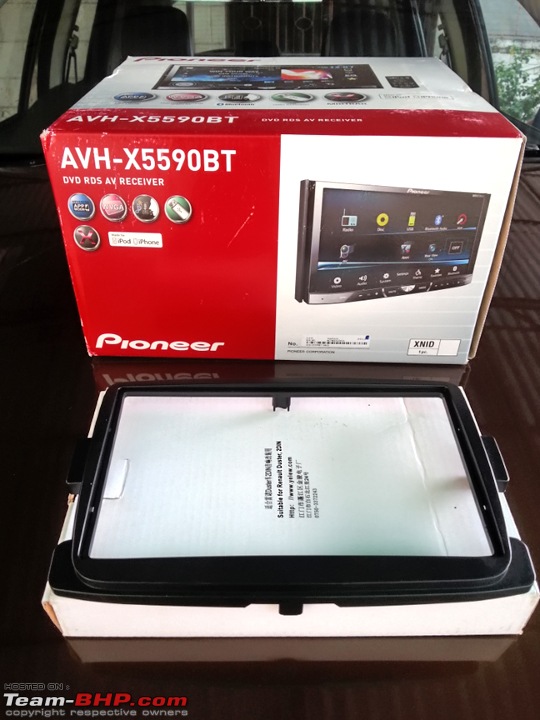

I always wanted to upgrade my head unit to a Pioneer 2 din but spending 30k was somehow holding me back.
Then came this Delhi trip with my family, my wife and me were at the front seats with my 5 yr old son had the entire back seat comforted with pillows to himself.
Since this was a long trip with 18-20 hrs in the car we allowed him to access his tab but results were not good.
He used to lie down on the back seat and play, result in a nausea feeling after some good 5-6 hrs.
Travelling at speeds over 100kms/hr, any type of continuous reading gives such a feel, at-least I do feel it pretty fast.
I did not put my head into it much and just asked him to stay upright.
But my wifey did.
Coming back from Delhi, she asked me how would it be possible for us to go to Sikkim on bad roads for a similar stretch of time, 18 hrs.
Can't we take the Honda Brio to Sikkim? (the Brio has a Pioneer AVH-X4490BT fitted)
I laughed and said the Brio would hang like a seesaw on some raods, why don't we upgrade the head unit of the Duster!,
son will then sit upright and watch his favourite movie without feeling nausea.
Wifey did not comment much but I took it as a consent
But with a condition, the finishing has to be clean.
The outer case of the OEM player is oval where as the Pioneer is rectangular.
That means the case/bezel has to be perfect, made for Renault Duster.
Only when I got that, I went ahead and purchased the Pioneer 2 din.
The stock steering control had to work,
hence a Pioneer-Renault steering remote interface was required too, got that for 4.5k
The OEM mic is made redundant too, Pioneer comes with a very sensitive mic, audio clarity of the BT is superb.

Sir tell me where you got the bezel and is it not possible to fit without it in rxe and how much of a dent it is in our pockets ,i am worried as i have already purchased pioneer avh2590bt and the bezel not present in packing
ashwinvardhan is offline
Old 30th August 2013, 07:41   #113
himadrimondal's Avatar
Join Date: Jun 2012
Posts: 422
Thanked: 918 Times
Ashwin, the bezel does not come with the pioneer, neither does it come with any of the systems.
You have to purchase it seperately, ask for it in the car accessories shop where you got the system from.
Should not cost you more than 1.5k
It will fit all duster models, if you intend to not fit the bezel, there will be odd looking gaps between the system and the dash.

@himadrimondal - Where did you get the case/Bezel from? and whats the cost of the headunit? Does it have a inbuilt naviagtion system?

Jsing, got the bezel from a shop in kolkata. The head unit costs 24k. Yes it has navigation, only when you connect it to your iphone. The entire phone is then reflected on the screen through Appradio application.
You can then browse, navigate or do all phone activity on the car head unit screen.
