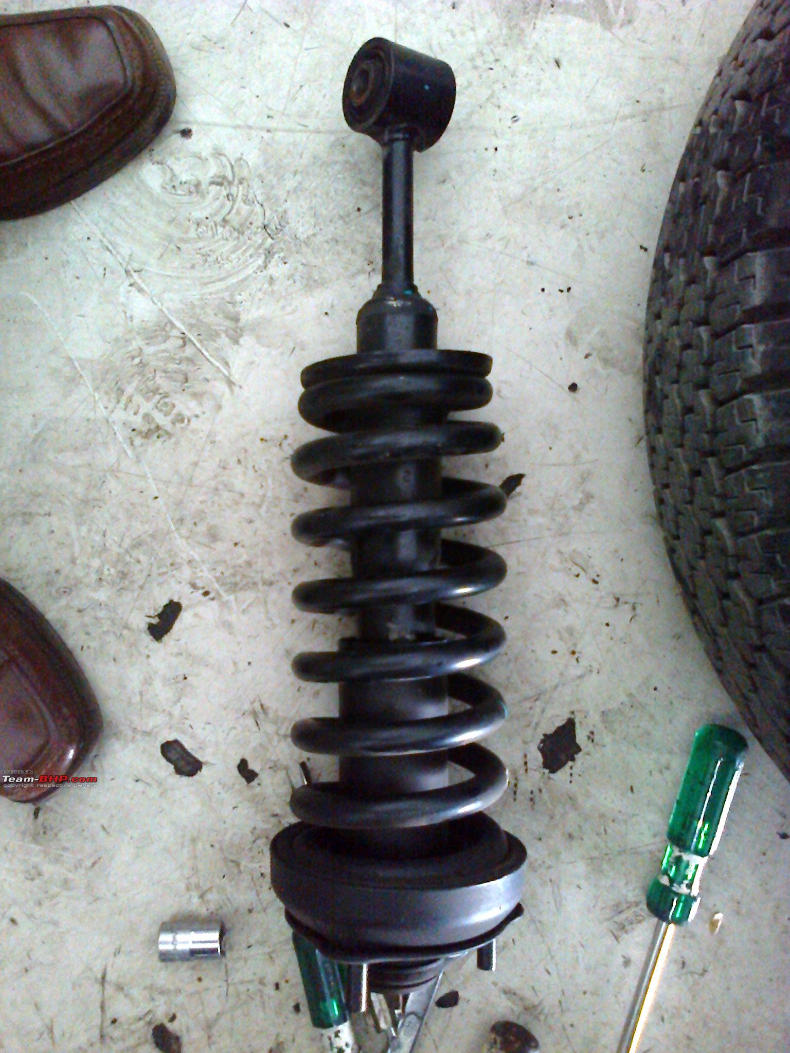

Final leaking shocker replaced today (front right).
These are made by Gabriel. MRP on carton (Mfg. Jan 2014) is Rs. 4437/-. Funny part is that the new shockers have "Safari MF 4x2" in blue on top and another white sticker saying "Merlin FR 4x2 5407 3230 0105" midway down.
Beastie winks at Snow White & Red Riding Hood. My Tata Safari Storme EX-201401130008.jpeg
The leak in the oil sump casing had recurred after 800+ kms. From the left side mainly, concentrated around the left most bolt. The gasket when opened was completely split at one place, letting the oil through (waiting for their photos, which will be shared with TATA as this is the first case at National at least).
A photo of the new gasket. MRP Rs. 152/-. Mfg. date May 2013.
Beastie winks at Snow White & Red Riding Hood. My Tata Safari Storme EX-201401130012.jpeg
They've kept the truck overnight for the gasket sealant to dry/cure properly. They fill refill the oil (and top up) tomorrow.
