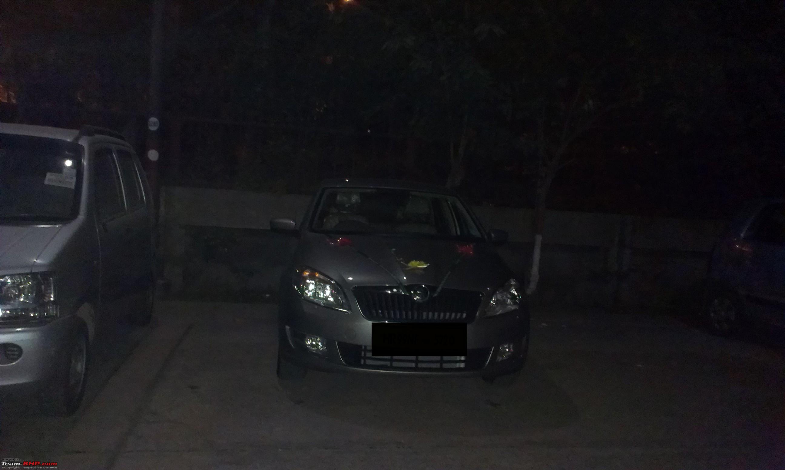

A few initial (and completely random - I am yet to do a proper photo session with the car) clicks of the car:
Skoda Rapid (MPI Elegance MT): Test-drives & Initial Ownership Report-12.jpg
Skoda Rapid (MPI Elegance MT): Test-drives & Initial Ownership Report-32.jpg
Skoda Rapid (MPI Elegance MT): Test-drives & Initial Ownership Report-22.jpg
Skoda Rapid (MPI Elegance MT): Test-drives & Initial Ownership Report-62.jpg
