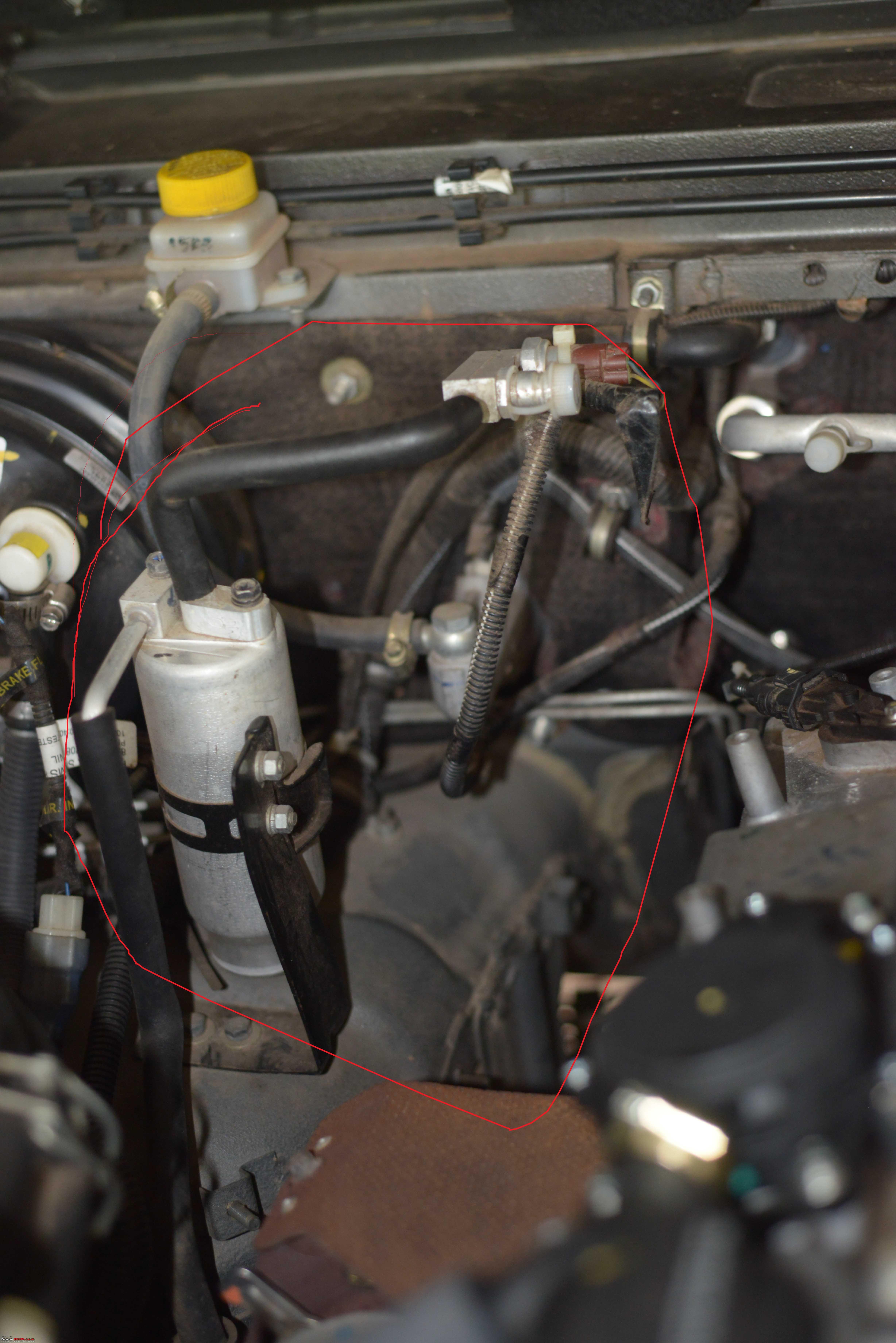

Extreme xtreme! Force Gurkha Xtreme 4x4 ownership review-20200503_174615.jpg
Can anyone tell me which component is this, is it related to AC?
It seems to be the accumulator or receiver/dryer of the air conditioning circuit. It is possibly Behr make.
