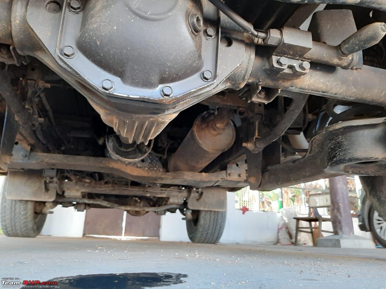

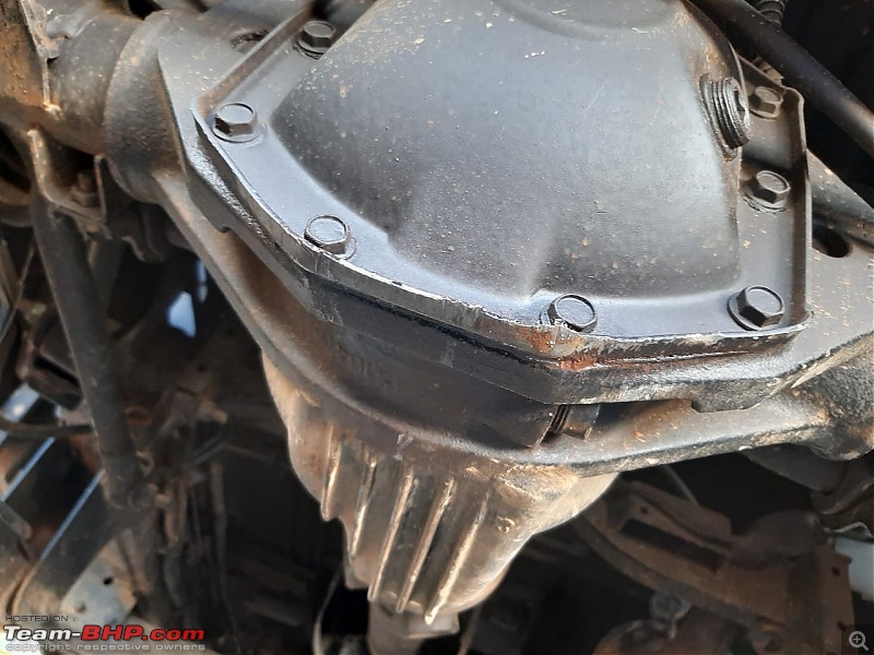

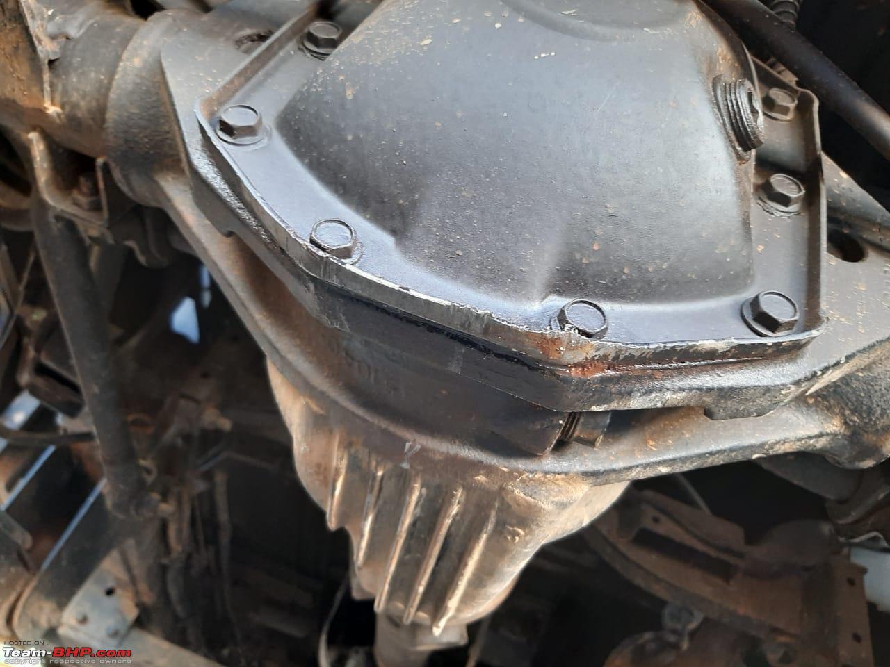

Hey all, just to provide a quick update on my Xtreme. I have been doing some mild to intermediate offroading with it and so far have thoroughly enjoyed it. For me the most impressive thing is the transition of the vehicle when it comes back to the road. After intense offroading it can get back to the road, and hit triple digits and drive like any other 'onroad' SUVs. However, I somehow managed to get a knock on my differential causing a small oil leak. Removed the casing and applied Anabond and its all sealed up now. My second service at National Motors, Pathanamthitta was as good as leaving it at home. Hence, got the vehicle checked at local workshop and got rid some minor suspension noises. With the lpandemic and my new work from home life, the vehicle is only used once or twice a week. Once I get settled into my new job, I am planning for a long trip with the vehicle till then nearby hills and estate will be my main adventure zones.
Here is a few images of my leaking differential. Big thanks to other Gurkha owners for helping me out.

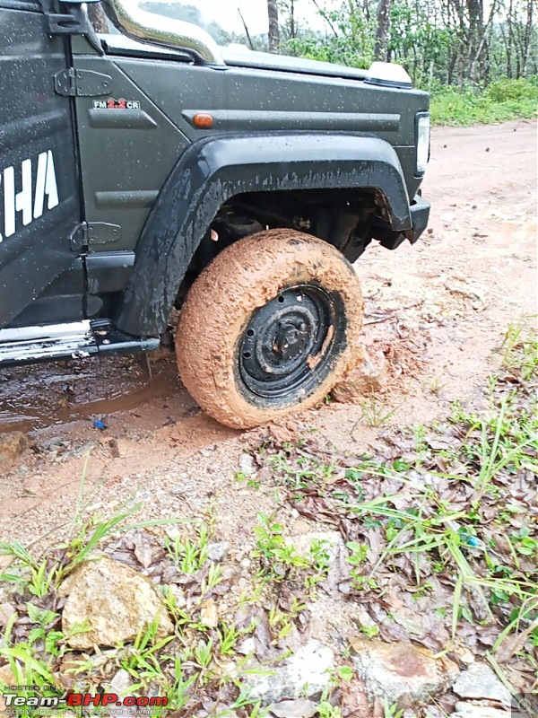

During offroading especially in slushy terrain, the vehicle just digs in due to its weight (2.5 tonnes). As you know, stock tires wont help either.

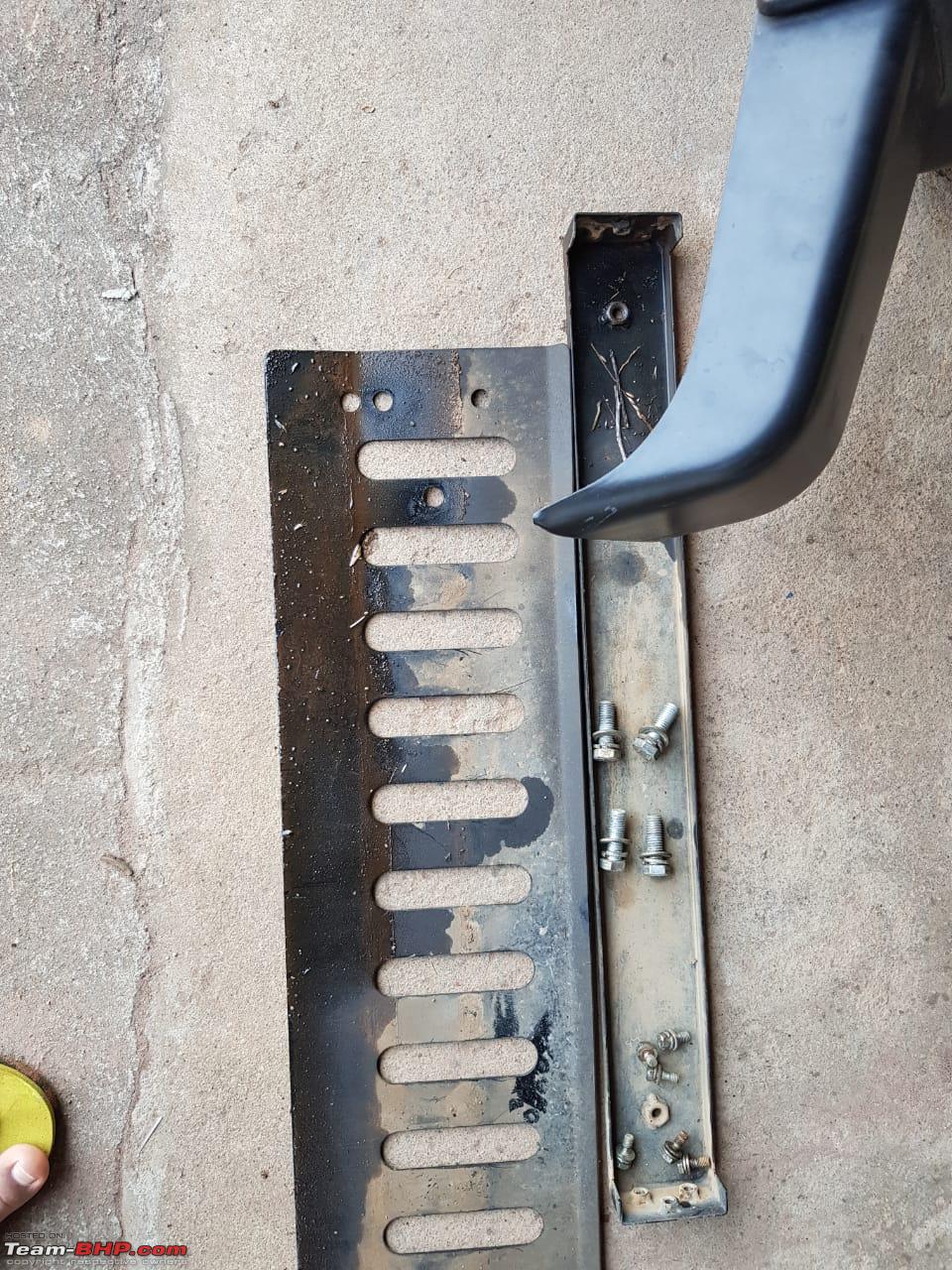

Need help from you people out here. Two days ago, my AC was not working (zero cooling). I took it to a local AC workshop. They found out that refrigerant was completely drained and suspected a leak somewhere. However, no leaks showed up when the checked with air. So they filled it back with refrigerant and they AC was working fine. Yesterday, I noticed few drops of oil spilled on the floor. I decided to remove the front bumper to inspect the issue.
Extreme xtreme! Force Gurkha Xtreme 4x4 ownership review-whatsapp-image-20210224-13.39.28-1.jpeg
Extreme xtreme! Force Gurkha Xtreme 4x4 ownership review-whatsapp-image-20210224-13.39.28.jpeg
Extreme xtreme! Force Gurkha Xtreme 4x4 ownership review-whatsapp-image-20210224-13.39.27-1.jpeg
Extreme xtreme! Force Gurkha Xtreme 4x4 ownership review-whatsapp-image-20210224-13.39.27.jpeg
As you can see, a lot of oil was collected in the skidplate. I feel that the leak is from the condenser. The oil is odorless and transparent. Leaking condenser at 8,500 kms? Does this damage the compressor?

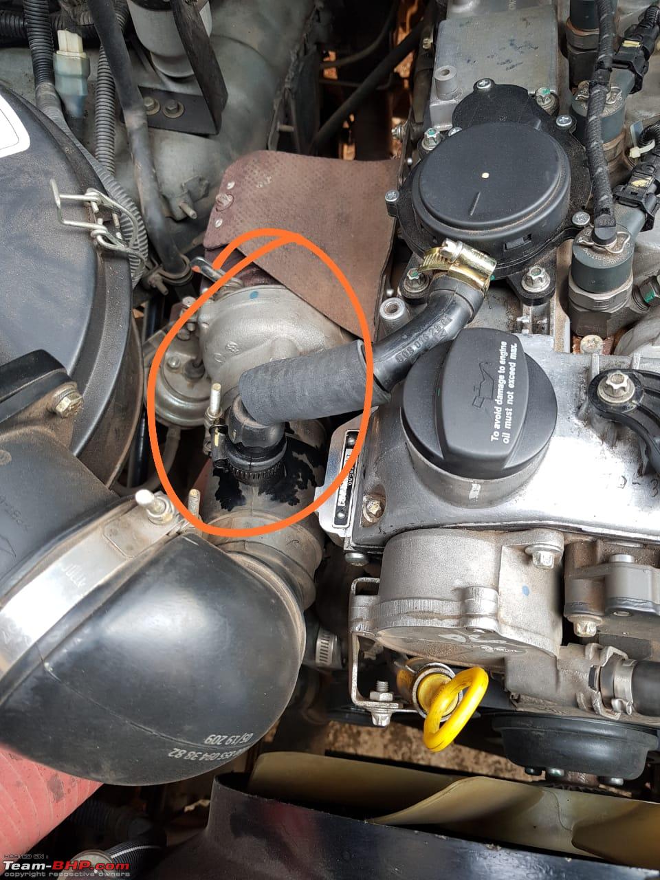

Well, that isn't the only leak. I am experiencing an engine oil leak near the engine oil filling cap for the last 2-3 months. The leak was very minute and it didn't go even after changing the oil cap. But surprisingly, while inspecting the condenser issue, I found that this leak has changed position from oil cap to PCV-turbo connection.
2 weeks ago
Extreme xtreme! Force Gurkha Xtreme 4x4 ownership review-whatsapp-image-20210224-14.08.04.jpeg
Today
Extreme xtreme! Force Gurkha Xtreme 4x4 ownership review-whatsapp-image-20210224-14.07.46.jpeg
The PCV was already replaced under warrant a year ago due to a leak at different spot. At the moment, I dont think that changing the hose clip will solve the issue, I feel like either the PCV or some breather is blocked/damaged causing engine oil to leak out from seals.
Anyhow, I am planning to take it to a local workshop tomorrow. Any suggestions from your part would be really helpful.

[quote=As you can see, a lot of oil was collected in the skidplate. I feel that the leak is from the condenser. The oil is odorless and transparent. Leaking condenser at 8,500 kms? Does this damage the compressor?[/QUOTE]
That oil is supposed to lubricate the compressor.
Better not run the AC until the leak is fixed.

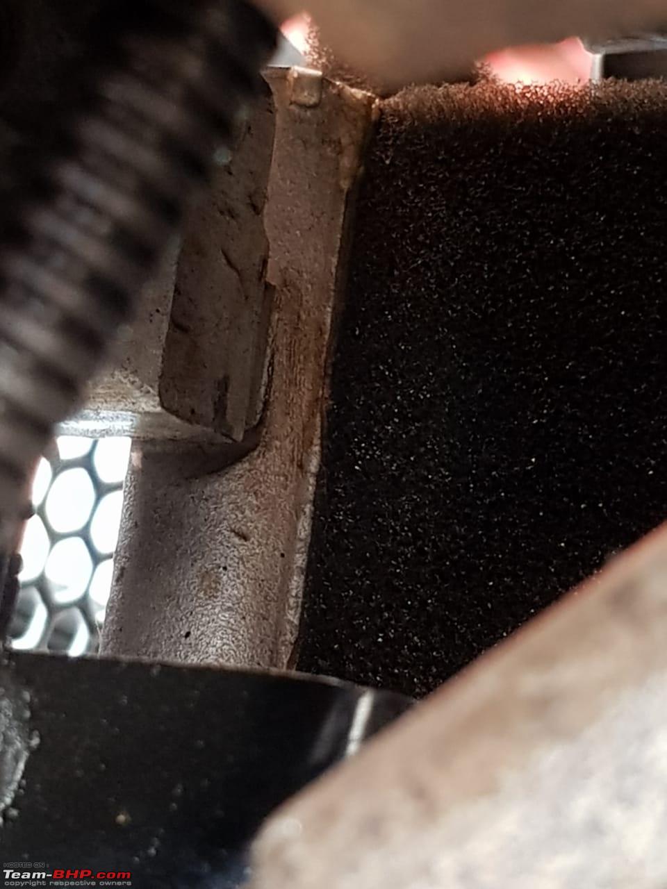

So with regards to the condenser leak issue, I took the Gurkha to National Motors (FM Pathanamthitta dealer). Only upon reaching I found out that they do not offer any AC related service assistance. Also, I found out that a lot of parts such as the AC components, turbocharger, intercooler, common rail, etc are not covered under warranty as these components are outsourced. So any issues with these and you have to directly deal with the respective makers. Force offers a mere 18 months standard warranty (no extended warranty) and these components are not even included in it .
Since driving around in this heat without AC is not an option, I took Gurkha to local AC shop. They found out a crack at the condenser inlet. Took the condenser out and welded the crack. Upon inspection the crack was due to a bend in the mount of the condenser. This improper attachment was also causing the condenser fan to rub and almost cut the condenser tubes. The attachment was corrected and proper spacing was provided between fan and condenser.
The crack at condenser inlet
Extreme xtreme! Force Gurkha Xtreme 4x4 ownership review-whatsapp-image-20210329-19.00.16.jpeg
Extreme xtreme! Force Gurkha Xtreme 4x4 ownership review-whatsapp-image-20210329-19.00.14-4.jpeg
The condenser fan almost cut the tubes
Extreme xtreme! Force Gurkha Xtreme 4x4 ownership review-whatsapp-image-20210329-19.00.14-3.jpeg
Extreme xtreme! Force Gurkha Xtreme 4x4 ownership review-whatsapp-image-20210329-19.00.14-2.jpeg
Welded and sealed
Extreme xtreme! Force Gurkha Xtreme 4x4 ownership review-whatsapp-image-20210329-19.00.14-1.jpeg
