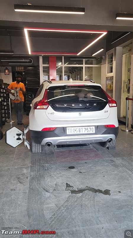

Got the 50K service done and the service centre reported an unusual pull to the right from their road test. I verified it my self and found a noticeable pull to the right. For the first time in 4 years, I had a bitter experience with the Service centre as they took more than 20 days just to resolve the issue citing various reasons. I had to then really put my foot down and escalated the issue with Volvo India after which it was sorted.
I got the car out while waiting for the part and got the Alloy Wheel repaired. The shop did a decent job and was able to take care of the bend to the best extent possible. He did have a professional machine and reviews were reassuring. We also found a crack in the Alloy after I noticed a loss of pressure in the tyre and he promptly sealed it. Was fairly happy with the outcome overall.
The bent alloy at the repair centre. Hard to notice the bend from this angle but it was prominent enough.
The Alloy Wheel Straightener machine
Had to again go for the Pirellis this time. They are rather noisy compared to the Michelins and Contis but what you get is excellent grip and traction at higher speeds. I hate the roar though!
They ultimately diagnosed the issue to be the faulty steering rack ( mostly the ball joint) but they decided to change it under Extended Warranty. The part was incidentally available in India ( sort of a miracle with Volvo) and they were able to get it in under a week.
Older rack removed
New rack installed

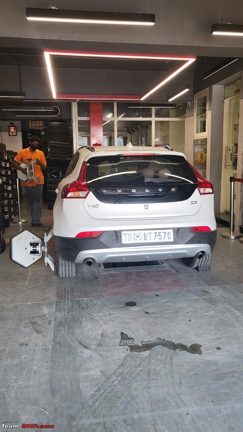

Got another alignment done after the Steering rack was replaced.
After the steering rack change and the alloy wheel repair the vehicle has been fine and steering seems a lot more effortless and smoother ( not sure if the older one already showed signs of issues that I wasn't paying attention to?)

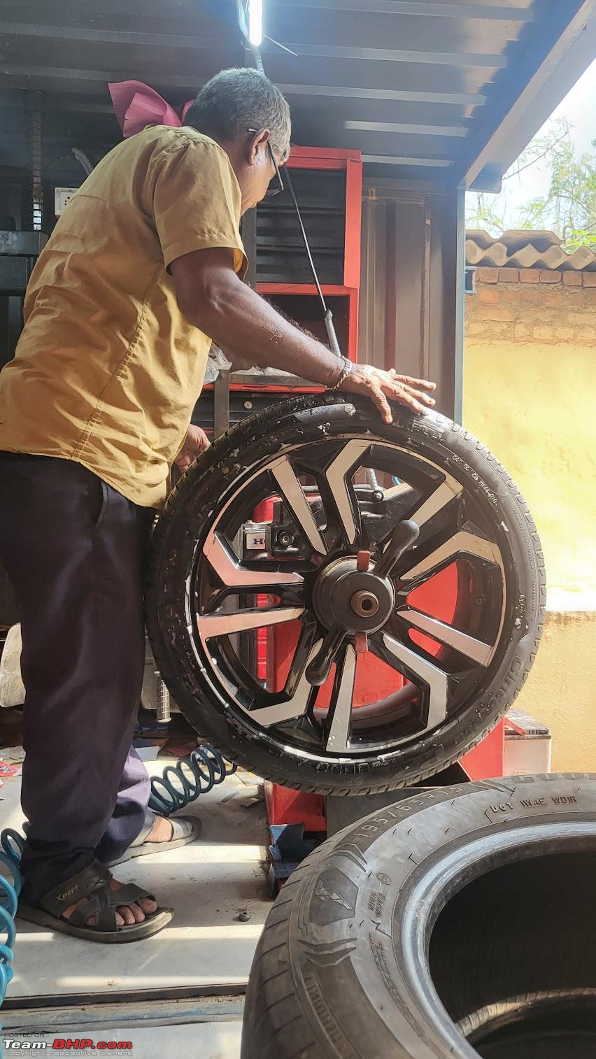

Thanks for the word of advice Turbanator. I actually sought help from a fellow Team-BHP member who gave a contact of a non-member who seems to be running the 245/45/r18 setup for over 1L KMS without any hassles on the same MY model as mine (Much like our other member Suraj) Another contact from Kerala who runs a Tyre business seems to be running the same setup in his V40 CC, I was told.
For now I managed to source a single Pirelli from TyresnMore whose service was pleasantly surprising. I ordered the tyre yesterday and I got them fitted right at my place by their team. They seem have a capable mobile setup and did a diligent job I must say.
Nevertheless I am pulling the trigger with the Conti 245s for the ultimate piece of mind on the upcoming trips and have decided to keep the Pirellis as a backup ( incase of any unforeseen extended warranty claims) where I can install them in just case.
Some pics from today's installation by TyresnMore.
The Nasty Sidewall tear due to a pothole ( I dread these)
New Tyre mounted and balanced ( although its out of balance now with the other set and I need to run an alignment and balancing when getting the 245s)
Their Mobile setup
New tyre installed in its place
Taking the car for a general check up tomorrow before a long trip that's coming up this weekend. Will post the impressions on the 245s from the trip.
