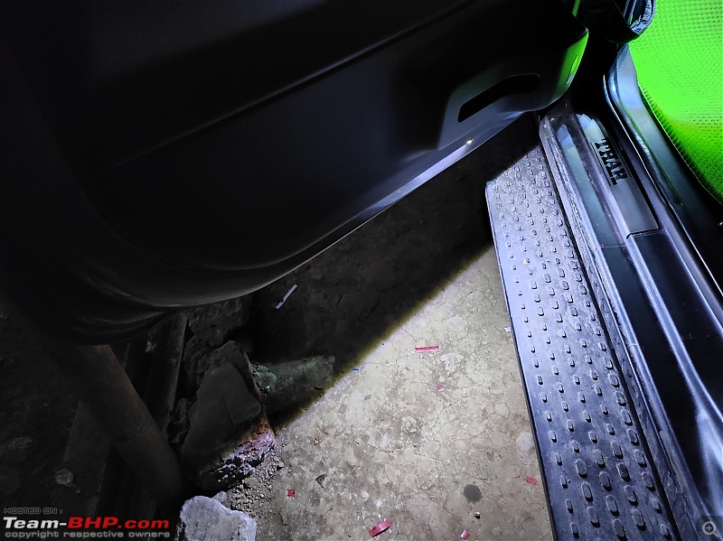

Another side Mod that was done were Footwell lights and Puddle lamps under the doors which switches ON when I open the door.
I will be removing few rubber seals and plastic trims anyway to route the wire for the rear dash camera unit, so took this opportunity to tap the door open power wire from the Dome light to power few led strips on the footwell and under the door to act as puddle lamps.
Placing the led strips below the door helps in the dark. Not only does it illuminates the ground or lack of ground below, but also illuminates the foot steps.
Positive wire for the circuit was from the door open power wire of the dome light. Negative/Ground is from a bolt screwed into a metal surface in the Passenger footwell. I have also added a 5A in-line fuse to the new circuit.
My ownership review of Mahindra Thar LX Diesel HT AT, The Gray Ghost-img_20220224_172208.jpg
Driver side
My ownership review of Mahindra Thar LX Diesel HT AT, The Gray Ghost-img_20220224_172147_copy_4593x3437.jpg
Passenger Side
