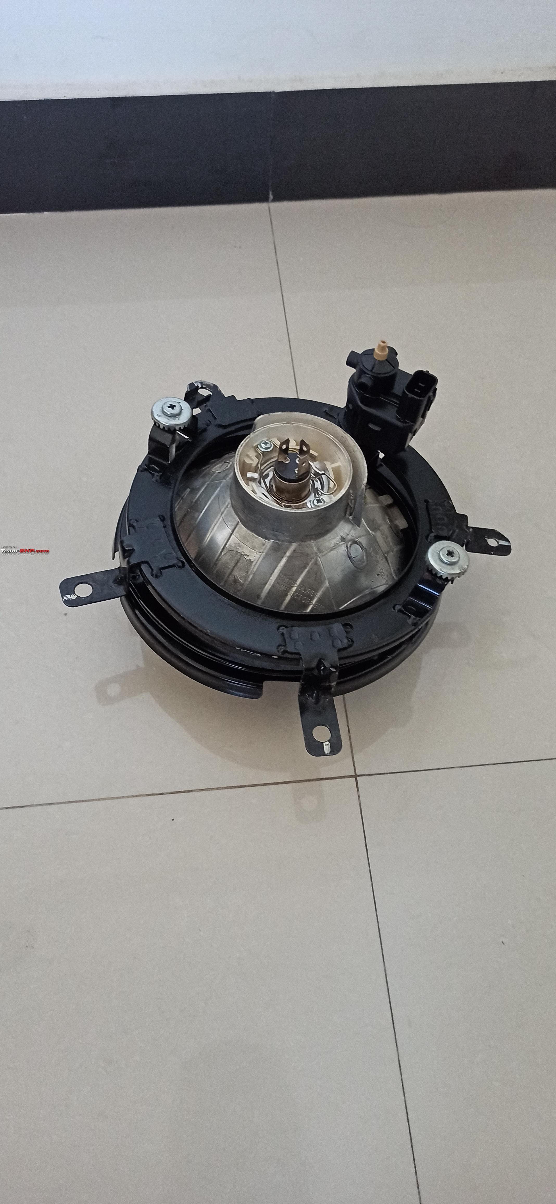

I mentioned in one of the previous post that I am planning to upgrade headlights.
I have seen infinite number of led headlights in real and flooded online which is a direct swap.
Few examples are minus type, wrangler type etc. Prices varies based on models.
But none of these will be any superior to a good halogen reflector lights. Majority of the Led headlamps are only good at near illumination and not in long distance throw.
Yes, there are branded ones from Morimoto or KC Hilites which are made for Jeep Wrangler. But the cost including shipping and import duties is kind of sky rocket.
Projector retrofit is a good option, may be I will think about it later. As there was no good projector set up, I decided to keep the halogen set up (Philips 90/100W) with Philips relay.
But decided to change the reflector to original Hella one. Stock is Lumax.
I sourced a pair of original Hella reflectors made in Germany which is made of aluminum die cast.
I did a DIY to swap the Lumax with Hella. I managed to swap without removing the grill and bumper. It was bit difficult to access the four bolts on the front side without removing grill.
All you need is a 10mm spanner and a star screw driver.
Steps below:
1. Take out the scrivets on top of the Grill
2. Take out the four bolts which holds the headlamp assembly to frame
3. Disconnect H4 Socket
4. Disconnect Headlamp Leveler motor
The headlamp assembly will come out.
5. Then you need to take out the two adjustment screws out from the assembly
6. You will see three small star screws which holds reflector to assembly. Take them out too.
7. Please make sure that u don't fiddle with headlight leveler motor
Now you have the reflector dis-assembled from the frame and fit back with Hella ones.
Please find more pics below:
Stock Lumax:
Initial Ownership Review & Modifications | 2021 Mahindra Thar-stock-lumax.jpg
Hella:
Adjusting Screw:
Initial Ownership Review & Modifications | 2021 Mahindra Thar-adjusting-screw.jpg
Stock Dis-assembled:
Initial Ownership Review & Modifications | 2021 Mahindra Thar-disassembled.jpg
Leveler:
Small star screw in assembly:
Initial Ownership Review & Modifications | 2021 Mahindra Thar-star-screw.jpg
I can see a big improvement in the beam pattern with lengthier and brighter throw after this mod. Pretty happy with this one.
