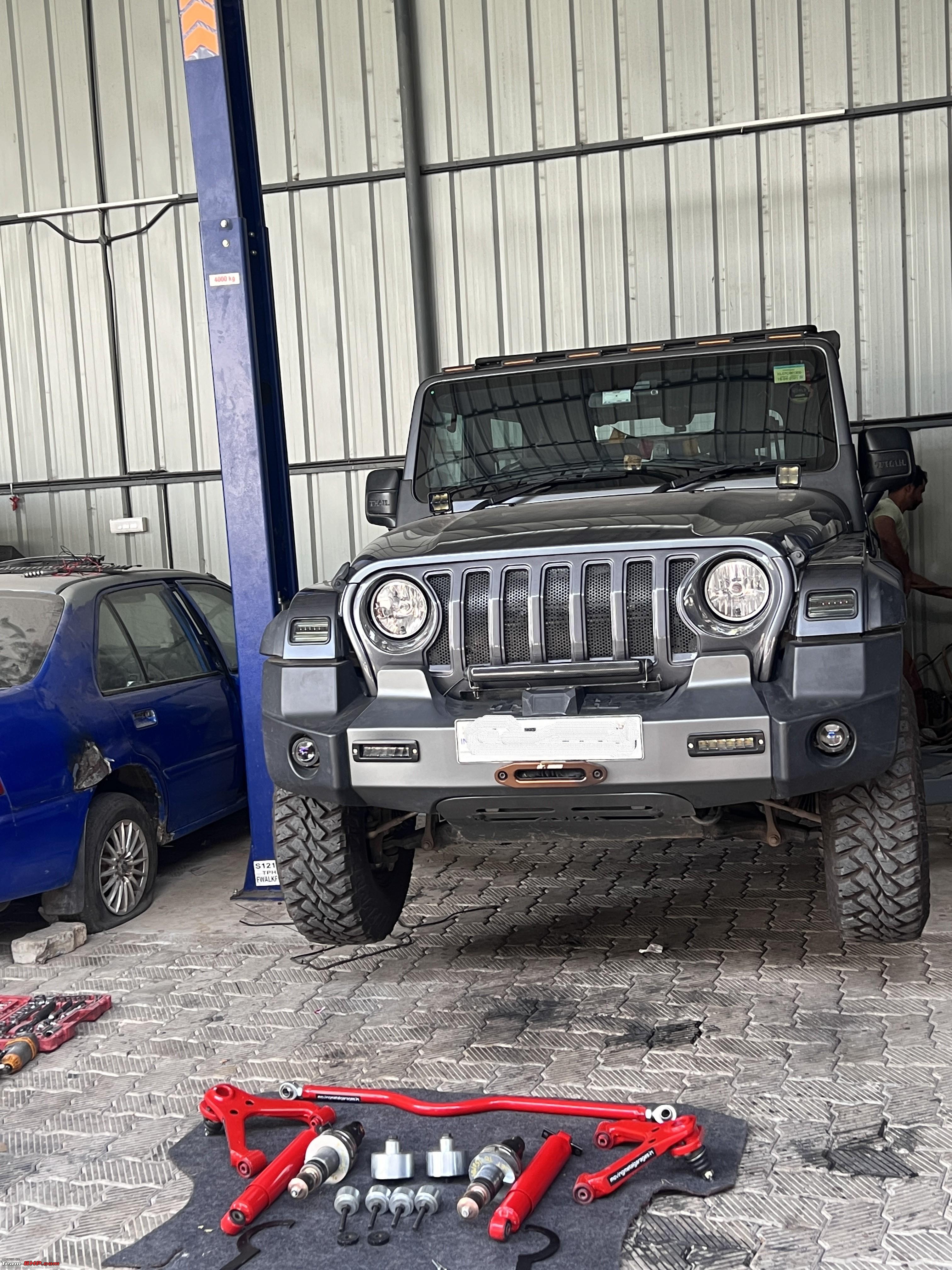

The job was started on January 1st in my FNG. We started off with the front.
Ready to party:
Attachment 2553234
Couldn't help but notice those sick flush mounted LED Bars on your bumper! Could you shed some 'light' for these LED bars:
1. Brand
2. Price
3. Which wiring kit you used?
Cheers!

The flush mounted ones are Hella black magic ones.
Cost is 11k for pair.
The long lightbar (covered) near the grill is Hella 470 pencil beam.
Both are connected to Auxbeam Gang Panel. I have detailed it above. Please check once.

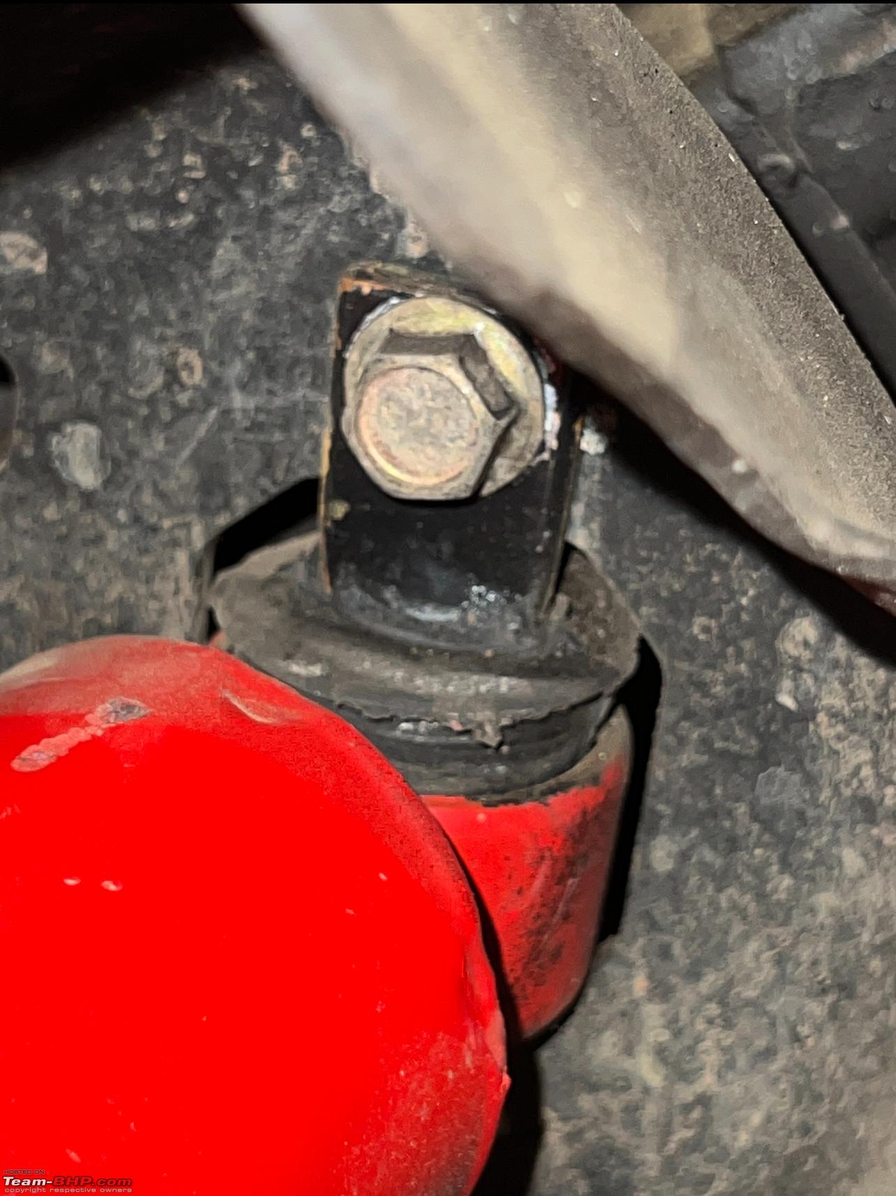

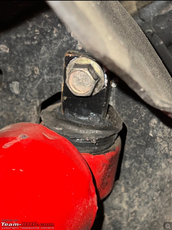

1. Rear Shock Bushes came out after a serious off-roading due to which there was squeaking noise. I have replaced those by applying glue as mentioned by Gagan from MMG and its all good now.

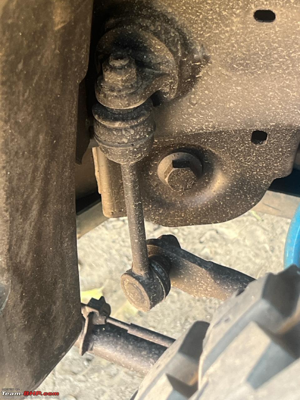

I wish the kit came with extended heavy duty rear sway bar links as well as the stock sway bar links seems to be bit strained with the lift. May be it will be ok if I re-adjust the same. I need to check that out. Gagan assured me that its absolutely fine and will not have any issues.
Rear Sway bar links:
Initial Ownership Review & Modifications | 2021 Mahindra Thar-photo20240203112539.jpg
