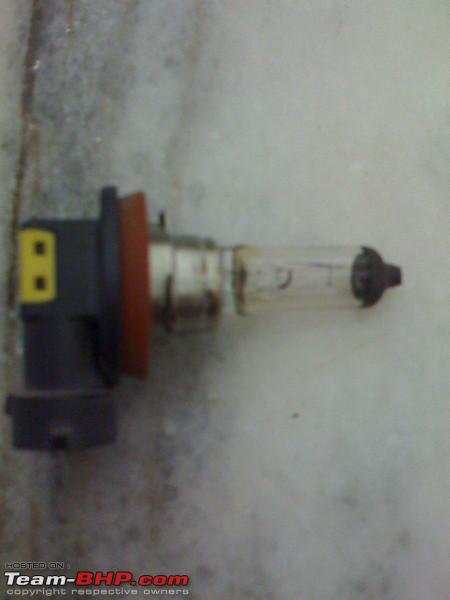

Yesterday night. when i tried to turn on my fog lamps. My RHS Fog Lamp blown. i heard kut sound from it. so I took the car to MASS in the morning. and had to replace it. cost. 1150 Rs.

Old 22nd May 2009, 18:51   #56
Posts: 2,089
Thanked: 716 Times
What could be the reason for it ? OverVoltage ?
I looks like that by fog lamp you mean just bulb and not full assembly is that correct ? If yes then 1150Rs for the bulb , What kind of bulb is there in fog lamp of Swift is it Xenon or something else ?
If it is normal H3 you could have purchased it from open market and installed it yourself.
A normal H3 which is used in Safari is 76 Rs only and full fog lamp assembly with wiring is 2800 ( for a set of 2).
amitk26 is offline
huh??! 1150 for bulb or for all the whole unit?

Posts: 1,674
Thanked: 6 Times
Looks like the whole fog lamp was changed, 1150/- for a bulb i don't think so but what i remember the bulb for swift fog lamp cost around 350/= or so at A.S.S.

Posts: 392
Thanked: 13 Times
Looks like I was cheated by MASS. I didn't know that.
Mechanic told me that it doesn't come with separate bulb. it comes with full assembly.
Attaching few pics of my old Fog Lamp.
