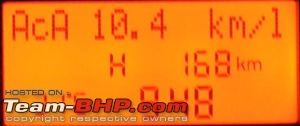

Another thing which intrigued me on the initial hours was the average mileage displayed in the My Car . It was then showing 8.4 kmpl with a total distance of 54kms and tonight it is showing 10.4kmpl with a total of 168 kms. I guess it will get better as more miles are covered.
