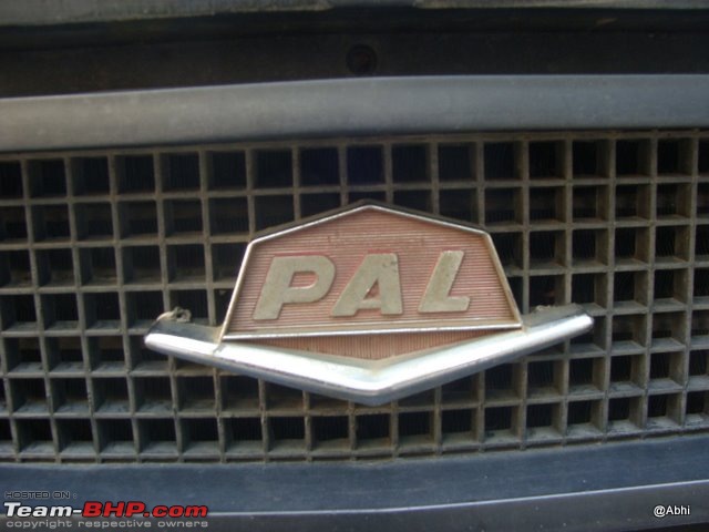

Well, after all this wait, the car has finally come home. I got a chance to take a few snaps which I am putting up here. Your comments and suggestions are welcome!
One thing I noticed, that this is not a '95 model, but a '94 model.
