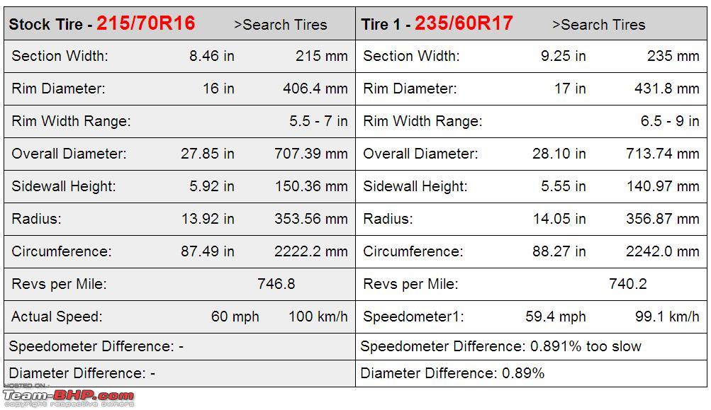

Why not? My regular wheel is R17, which means its has a 34" diameter, or approx 860mm. The tyre is 235/60, which means the sidewall is approx 141mm. This adds up to a total of 1142 mm.
In contrast, the spare wheel is R16, which means 812mm. The tyre is 215/70, i.e. sidewall is 150mm. This adds up to a total of 1112mm.
Hence a total difference of 3cm height on one wheel. How does the difference between rim size and OD come in to the picture?

The difference in diameter is <1% and hence, well within permissible limits. I don't see any issue in using this size of spare well. Yes, the handling will be different, as one tyre doesn't have the sheer grip of the others. It is best to maintain an extremely sedate driving style (60 - 80 kph) when on a space-saver spare tyre.
I can't understand why your Captiva was tilting to one side though. Unless the spare had no air in it...
Comparison prepared using the awesome tool on 1010tyres

Your querry has been addressed by GTO - hope that makes it simpler to understand, with the chart & all the numbers on it.
Attachment 843825
This is self - explanatory - trust your doubt is put to rest
