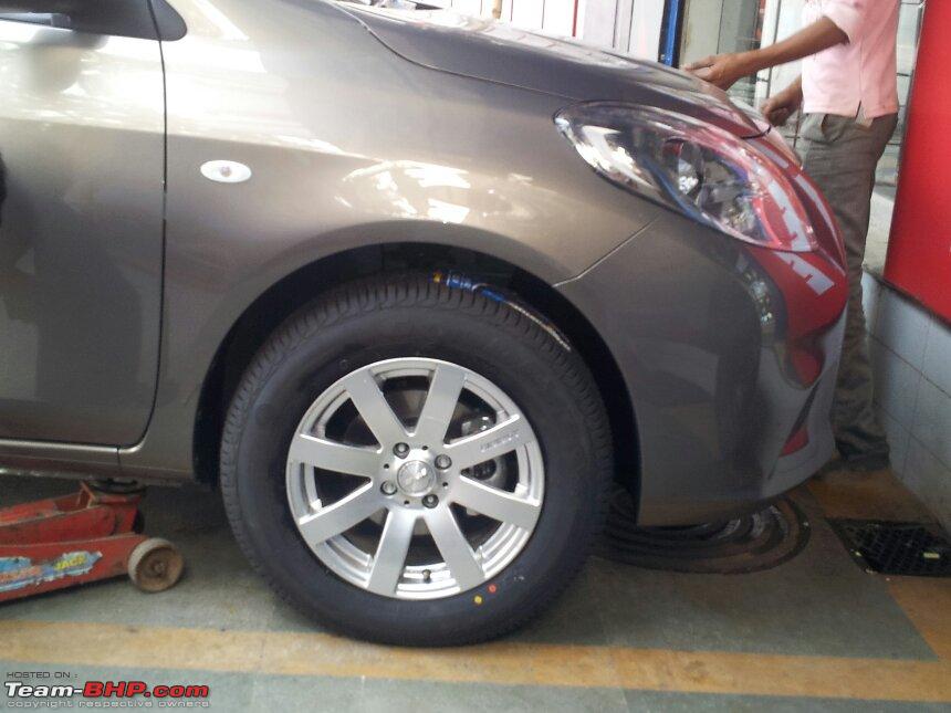

Finalised tyre size / wheels.
Getting them fit tomorrow. A teaser pic of the alloys.
Opinions welcome since its still alterable .. Attachment 897548
These wheels look pretty decent on the sunny. Gives it a family look. These alloys some how remind me of the S320's alloys.
