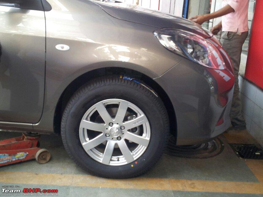

Finalised tyre size / wheels.
Getting them fit tomorrow. A teaser pic of the alloys.
Opinions welcome since its still alterable .. Tyre upgrade for the Nissan Sunny-20120305_1607491.jpeg

Looks neat like the OEM one, if that's what was intended, well & good. else you might have to look for other options to make it look different.
Also, can you please share the rest of the details like OTR and how does the car feel after tyre upgrade?
Some more pics of the car also please.
