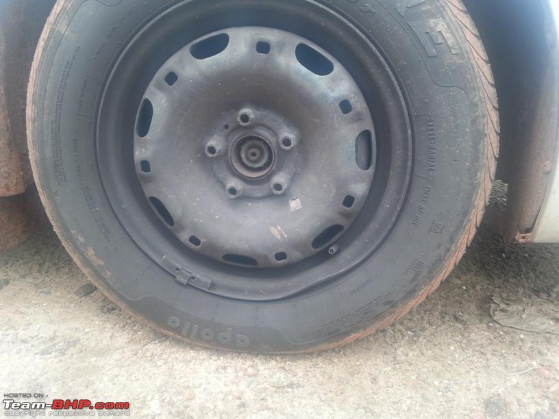

Urgent - Rim Dented and a long travel ahead
Folks, Crazy last couple of days. Resigned from my job at 3 AM and drove down from Mumbai to Goa, and after reaching goa i realized that the rim of front right tyre is dented. It could be i might have hit some pothole on the way. Anyway, m attaching the pics of the tyre and would appreciate if folks/experts here could give their views on a few questions i have -
1. How bad does it look? Do i need to get it fixed right away or is it ok to drive down to Mumbai and get this attended there?
2. If driving on highway in unsafe with this condition, then could any suggest a good repair shop in Goa where i could get this thing repaired?
3. Lastly, my understanding is that it is just the rim that has got damaged. I checked price of rim at vokswagen goa and they said Rs. 1300. Am i on the right track or missing something?
thanks.

Re: Urgent - Rim Dented and a long travel ahead
Seems pretty good from the outside atleast. Remove the wheel and just check the inside part which faces the brakes.
If your tyre is not losing any pressure, you can drive back to bombay, but you would have to check it every couple of hours just to be on the safe side.
I have driven with a bent steel rim and alloy for thousands of kms before even attending to it, so my experience has been ok.
The best option is of course - change the rim. If I were in your place, I would buy a new one just for the peace of mind.
Not if you are driving safely. Any local mechanic shops can bend it back to shape, inquire with your neighbours / hotelier.
Price quoted seems to be fair from the A.S.S., but you can get a good 2nd hand one in bombay for less than half the price.
I understand that you are passing through a bad patch, but it would be best if you drive back sanely.
Folks, Crazy last couple of days. Am i on the right track or missing something?
thanks.
Not a major one, just the lips. Remove the wheel from the car and gently tap the rim back in shape.
