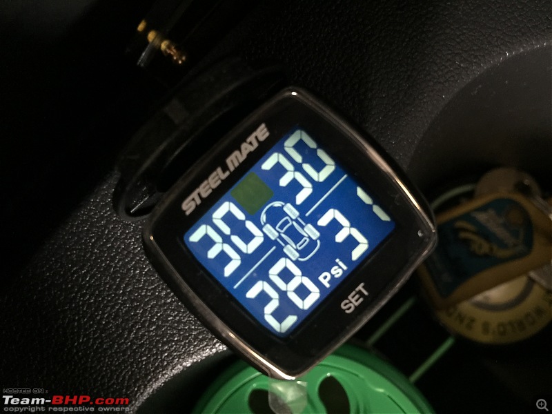

The TPMS Screen

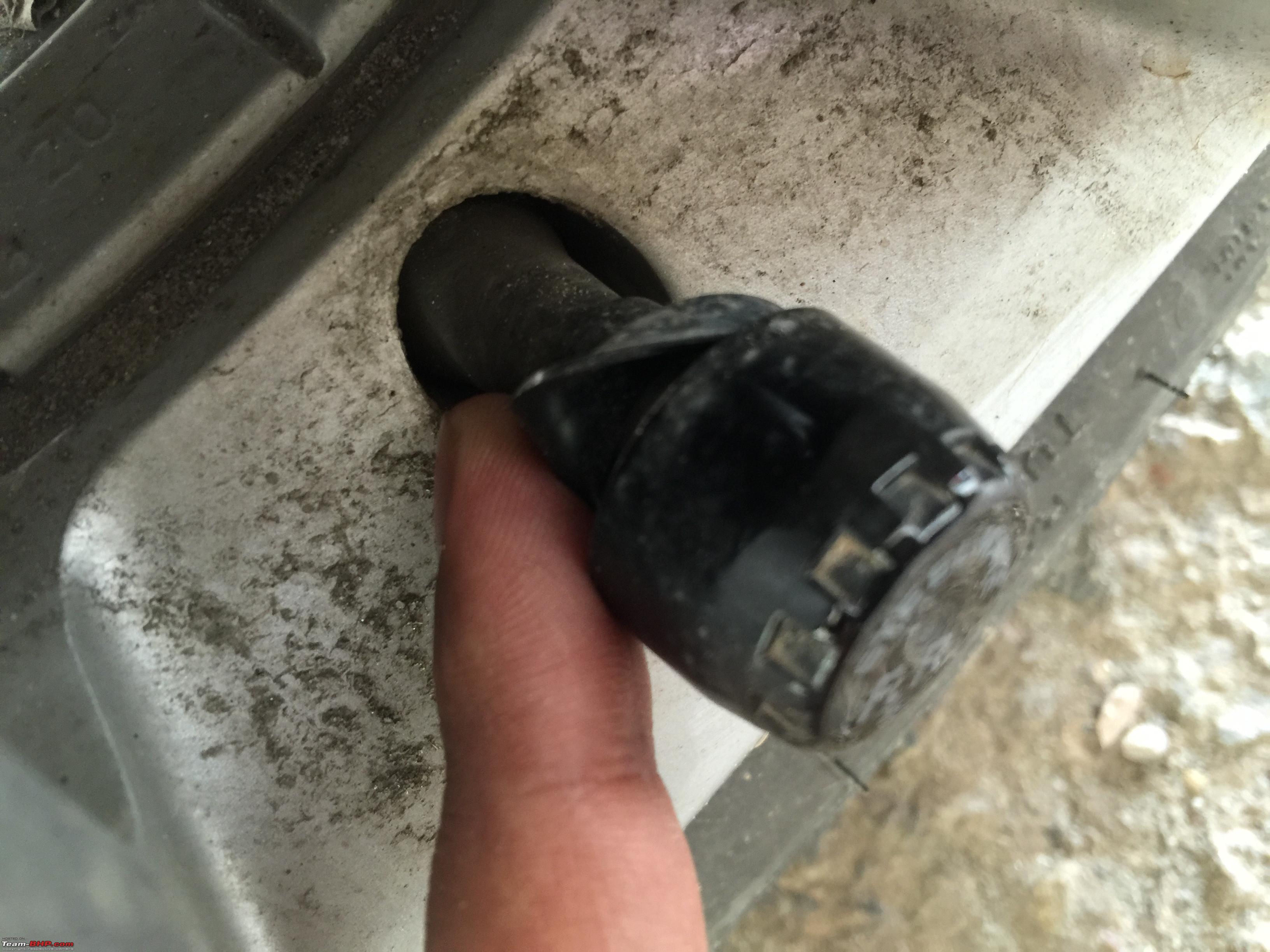

Installation was a simple DIY. The steps are mentioned below:
  1. Unscrew the valve cap of the tyre
  2. Cover the valve with the rubber sheathing
  3. Screw the tamper proof nut
  4. Screw the Sensor Valve & tighten the tamper proof nut counter clockwise where the sensor was screwed on clockwise
  5. Settle the rubber sheath so as to cover the rear of the sensor to ensure waterproofing

  8. The sensor will start to calibrate. Keep the SET button pressed for 30 seconds and all the pressure details of the tyres will display on the unit
  9. Incase the sensor is unable to give any reading, recheck screwing the sensor on the valve and try SET button again
The results of the efforts

  • Crisp display of all 4 tyre pressures in both PSI / Bar
