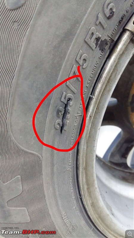

While i too would suggest a tyre change for peace of mind personally i feel that tyres are designed keeping in mind a lot more abuse than this particular damage. Case in point is my Rexton's tyres. They were developing cracks on the inside wall which were never visible to the naked eye. The only time it could be seen was either when it visited the workshop or my tyre guy for routine balancing/alignment. Especially the last time when i returned from a long highway trip including a drive on the yamuna expressway and part of the agra - lucknow expressway with the car fully loaded with luggage and passengers. Shot off a mail to the MRF people and their technician saw the tyre and explained that contrary to popular belief one should have tyre pressure at a 2-3 psi higher than recommended on long highway drives since it helps the tyres stay cooler.
You can see the cuts my car's tyres had for reference. And these were due to the tyres heating up by running it at the recommended tyre pressure! Icing is that i didn't know the potential hazard of the condition since i only get my tyres inspected once in 7-8k kms!

Those cuts don't look spontaneous ,IMHO, but rather a result of damage to sidewall from some sharp stone or Boulder etc. Or they may be caused due to rubbing of tyrewall to roadside when the wheel climbs from lower side footpaths , which are 'kuchcha' on many of our smaller roads. The tarmac is 4-8 inches higher in some instances.
Slightly higher pressure tyres do stay cooler. If you remember the British F1 race from couple of years ago where people had multiple tyre failures, Pirelli's stop gap remedy was 2 psi higher pressure.
Explanation is pretty simple:
A lower inflation leads to more tyre contact therefore marginally more grip. However, more contact = more friction - hence the potential for higher temps with lower inflation.
Higher inflation does the opposite. Higher inflation on highway drives also aids FE marginally due to aforementioned less friction.
Always note that this is a small adjustment. If your recommended pressure is 32, then 34 is okay - not 40 or something absurd like that. Typically, 10% above recommended is the limit so that between filling air you run within a range of 10% above to 10% below. Also note that cold tyre temp is important and not to check the pressure when you're straight off the highway after a 200 km run.
Well i had 4 tyres replaced initially and 3 of them have been changed as of date under goodwill warranty in the course of 2-3 months so its definitely not because of rubbing of sidewall. The car is only driven on well made highways and in the city with no offroading at all and it doesn't even go to any area where its needed to climb any curb or footpaths.
The car came originally with Hankooks which performed flawlessly while i think the MRF wanderers are inherently defective in this size configuration. It doesn't help that the size is exclusive to the Rexton and the Rexton hasn't sold in numbers for the tyre guys to do any research. You can read in my review of the car how difficult it has been to source common parts like tyres and battery for the car.
