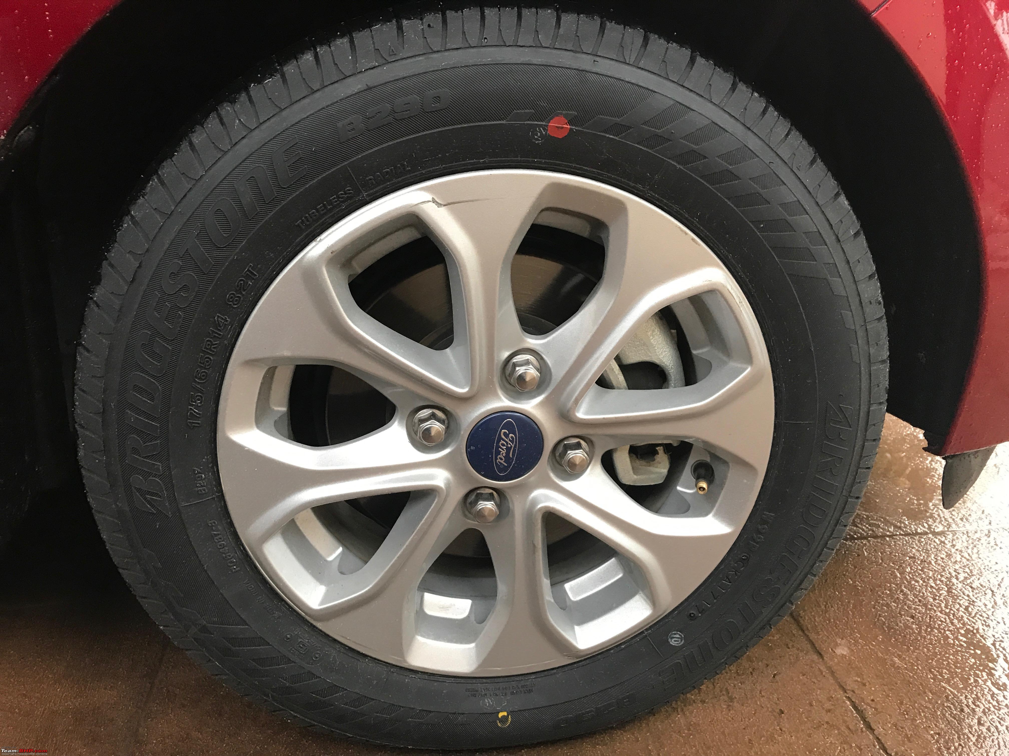

I can confirm this news. I had always felt the tyre noice inside the cabin in my Figo (1.5D Titanium). Being my first diesel car, I thought this was common and never gave it much thought. The sound was quite annoying on the highways, especially if I wasn't playing any music.
Recently I started feeling some rattling noice while idling and wanted to get it checked. I also thought I would get my wheel alignment done since it had been a while and I was planning a trip soon.
So, on Thursday, 17th Aug I took the car to Cauvery ford in Bangalore. I explained the SA about the issue and he joined me on a quick ride to check the issue. While in the car, the gentleman explained to me that the rattling noice was from the headlamp and that it was a common complaint. He said he'll get it fixed. I also mentioned to him that the noice in the cabin was more at high speeds. We tried to find a long stretch and to our luck found one and gave it a go. Immediately, he said there is noice from the tyre and needs to be examined. We bought the car back to the service centre and I went on my way after requesting them to get the tyre issue checked.
Normally, I would get back the car on the same day after the service. This time, however, I didn't hear from them. I tried calling them up by 6:30 PM and no one answered. The next day, I called the SA and he said they had to keep the car as he had not received a reply from Ford yet on the issue with the Tyre - Apparently they have to send an email to ford about these kind of complaints and shall have to wait for their reply.
By evening, the SA called me back and said that they had received a reply from Ford and that they had instructed them to interchange the tyres and check for the noice. Itseems, even after that the noice was still there. So he said, he had mailed ford back again informing them of this.
The next day (that is, today), I received a call and the SA told me that Ford had agreed to change the Tyres on warranty. By this time I was aware of this thread and I asked for a change to Michelin XM2 tyres. He said, Ford had specifically given only 2 options to them - it shall be either Bridgestone or Apollo. I went for Bridgestones.
As I had clocked 10k+ on my car, they asked me to pay 25% of the total amount. The amount came up to Rs.5745. They didn't change the stepney tyre though, even when I insisted that they should.
It was raining heavily today I was not able to check the post tyre-change ride quality. Although the cabin noice had significantly reduced. It could also be because of the fixed headlamp clutter.
Will keep you guys posted.
