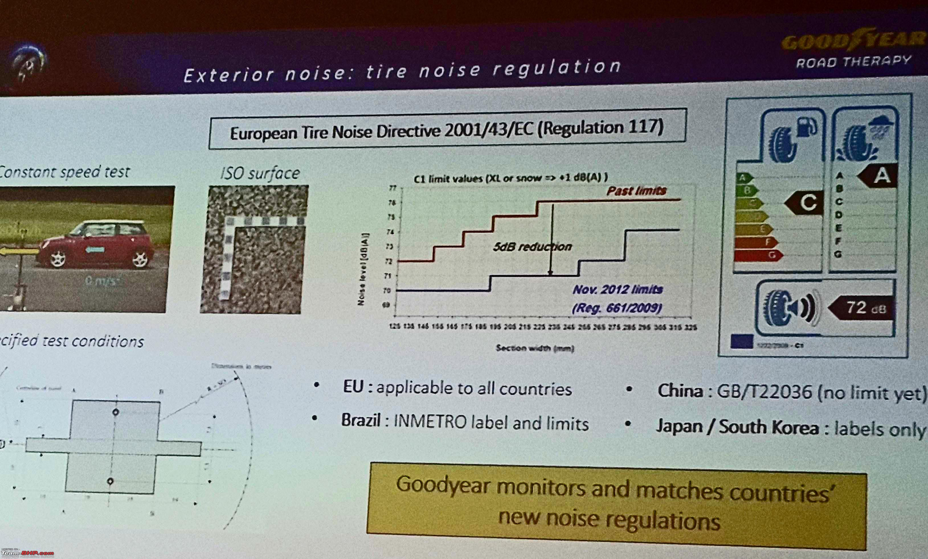

Pass-By-Noise Demonstration
Goodyear claims that their QuietTred technology reduces tyre noise. The tyres use a dampening tread design for a quieter ride. It includes an increased number of pitches, closed grooves and different shoulder design.
People generally associate low noise levels with a relatively soft compound performance tyre. Goodyear took it upon themselves to prove how quiet the EGP series tyres are even from a bystander's point of view...errrr hearing in this case :

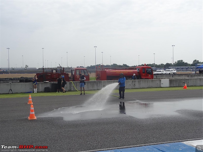

Care was taken to maintain the wet patch in identical conditions by making use of mobile mini-tankers parked along the track:

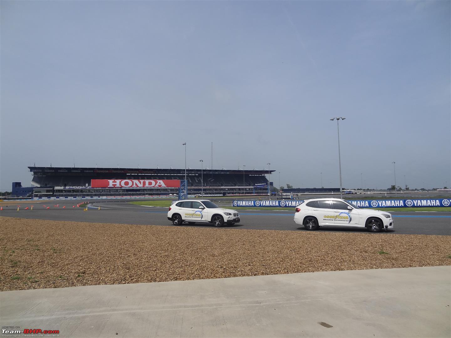

Two previous-generation BMW X1s were going to be used. Initially, I wasn’t so sure that the entry spec engines were going to make us happy:
Driven: Goodyear EfficientGrip Performance Tyres @ The Chang International Circuit, Thailand-dsc00647-large.jpg
However, the Goodyear team had outlined a neat layout for the experience and my heart only yearned for a few more laps around the same:
