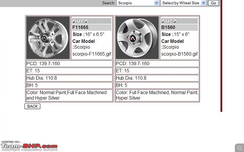

Rajan,
I had a look at Aura's website and they have alloys for scorpio that have the PCD between 139.7 - 160.
See the pictures below.
Question: Is the same wheel ok for PDC between 139.7 - 160 OR does this mean that in the same pattern you get these alloys in the PDC ranges from 139.7 - 160?
That means this particular design is available in both 139.7mm and 160mm PCD, it is not a range. So you can't use former scorpio/safari alloy.
ohhh.. that helps..
