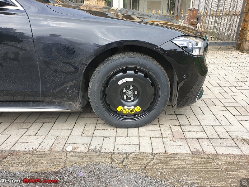

Driving inside Lonavla, enjoying the lovely weather with the windows down and I hear a loud POP & HISS. Immediately knew its a tyre gone. The CBU S-Class comes with a horrid low profile tyre setup on 20 inch rims! Thankfully, the CKD will be coming with 18-inchers. When I was swapping the tyres, I noticed that the jack has been used on this brand new car. Clearly, someone else also faced the same problem. Imagine, this was within a nearby hill station on rough roads (not even a pothole). A car I'd love to go to Goa in, but sadly, these 20-inch wheel variants wouldn't be up to the task. Wait for the CKD with 18s, guys.
Even worse was driving all the back at 80 - 90 kmph! Because the S-Class has a staggered setup, you have 3 different tyre sizes when using the spare. Completely messes up any expectation of handling.
