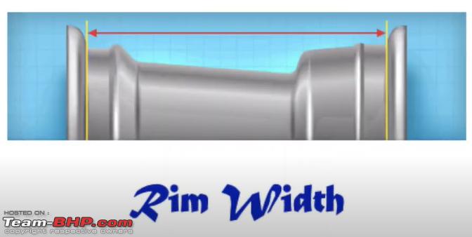

Rim Width (6j, 7j, 7.5j..)
Name:  RIM width.PNG
Next topic is about RIM width. There is another number that comes with the alloy wheels for e.g. 17" 7j, 16" 6j etc. This is nothing but the width of the alloy wheels in inches. According to the width of the tires used, the width of the alloy wheels should be chosen and it should ideally stay within the recommended width.
Below is a chart that depicts the same:
Name:  Width recommendations.PNG

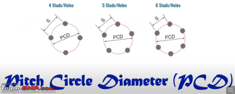

Bolt Pattern/ Pitch Circle Diameter (4x100, 5x114.3..)
Alloys can have 4, 5, 6 or 8 holes and different measurements which is called the Bolt Pattern. Pitch Circle Diameter (PCD) is the diameter of that circle which passes through the center of all the bolts hole or wheel bolts or wheel rim holes or stud. You don't need to know the technical details on how to measure this because according to our car's model and year, every manufacturer has set a PCD value for the wheels which can be easily checked online. There are wobble bolts available and wheel adapters available to change PCD but it is recommended to go for the exact fitment.

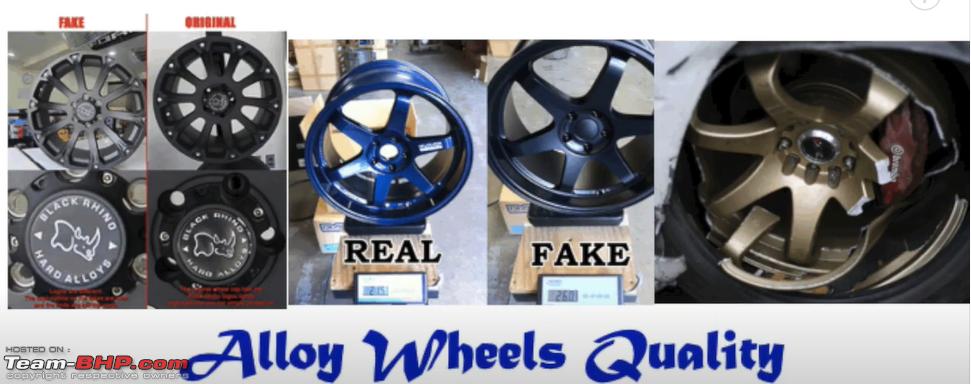

Alloy Wheels Quality (Replica vs Original)
Replica wheels are very common nowadays. Wheel shops cannot be blamed as they sell what's in demand in the market. People look at style and want expensive branded wheels at a cheaper price. Brands like Vossen, Rotiform, BBS etc. are the most copied brands. However, if you check these brand website, you may notice that most of these wheels start at bigger sizes like 17" or 19" but replica wheels are available in the same design for smaller sizes as well. The main issue with these wheels is that we do not know if they meet any safety standards. When you opt for alloy wheels you also need to check if they meet safety standards and certifications like TUV, ISO 9001: 2008/2005, NAD, VIA etc. Eventhough, the replica wheels are cheaper than what they copy from, they are not really cheap. We can get other original branded wheels for the same price or even cheaper.

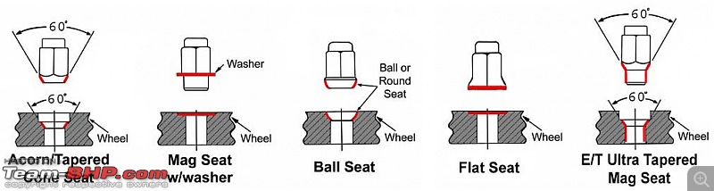

Another factor that decides the quality of wheels is the manufacturing method. Forged wheels are stronger and lighter than Low Pressure Casted wheels but also very expensive. In my opinion, Low Pressure Casted wheels are good enough unless your purpose is racing. Lower quality wheels are gravity casted which is not recommended.
Bonus Topic: Wheel spacers and Adapters
Wheel spacer is a metal plate placed between the alloy wheels and the bolts to push the alloy wheels outwards. Wheel spacers come in different quality. Some wheel spacers are quite loose and adds another moving part between the wheels leading to friction and it is bad for the car. If you are still going for it then go for reputed brands like Eibach.
Another option is Wheel Adaptors. Suppose you have a very rare bolt pattern for which alloy wheels are not available. Then one option is to go for Wheel Adapters which can fit into your current bolt pattern and change the bolt pattern/PCD to another one. For e.g. if your bolt pattern/PCD is 5x120, using wheel adapters you can change it to 4x100 which is a more common bolt pattern. It may be better than wheel spacers as it is bolted on but still adding another component is not recommended.
You need to consider other factors which as braking, turning radius etc. when you make the wheels sit wider using adapters or spacers.

Recently, I went to a reputed Alloy/Tyre shop in Chennai to replace my car tyre and was shocked to see the movement of replica/low quality alloy wheels sales.
Dealer mentions that it is a replica and life will be low when compared to the original,Still people procure those for a good cosmetic appearance in low cost.
Welcome. Yes, Replica is very common now. There are shops dedicated in selling them and Every other wheel shop also sell them along with branded wheels. People go for them only because of the looks as they replicate wheels which would otherwise cost them in lakhs. No one cares for safety unless something bad happens to them.

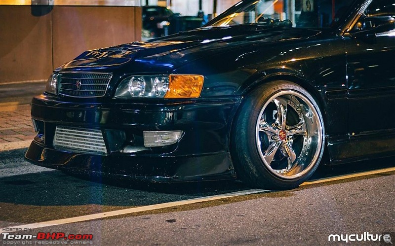

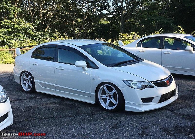

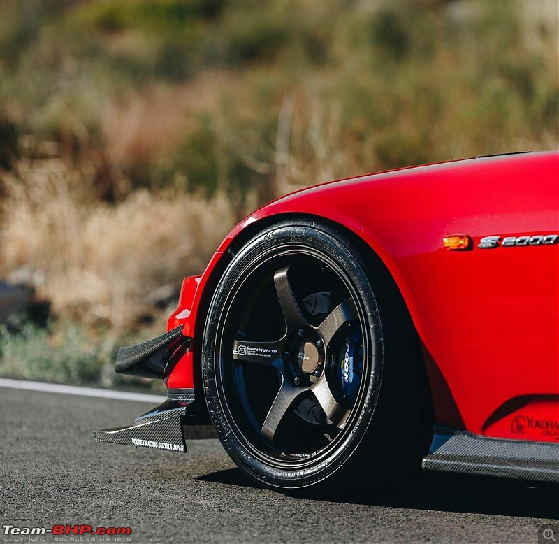

Japan makes the best imo, you have wide variety of top quality wheels, like Volk/Rays, Advan, Enkei, Work wheels, Weds etc. You have everything from full on lightweight forged race spec wheels to Hot boi deep dish style wheels.
I mostly like 5 spokes so its between the Advan GT for track and the Work VS KF or Weds kranze cerberus 2 for the hot bois show builds( this preference also changes every month )
Advan GT
kranze cerberus 2
VS KF
Understanding Alloy Wheels (width, PCD, offset etc.)-5e3283d5ebaa4092b6f2412f59ed9f7a.jpg

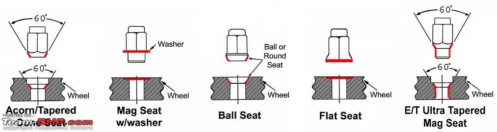

Another important factor while upgrading / changing from OE wheels is Lug nut type & Profile
