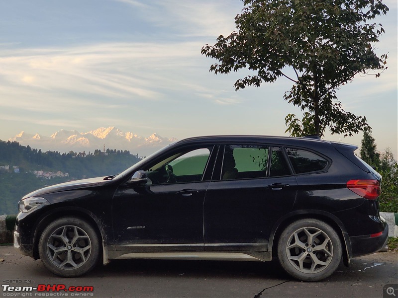

Yes Indeed. I am using BS Turanzas and the experience has been very good so far. The ride has become much more comfortable as compared to RFTs. The handling has taken a very minor hit. The grip is good as well. Also, I have used the tyres for only around 6k kms, so long term review will take sometime.
Here they are tackling the Himalayan Roads with ease
