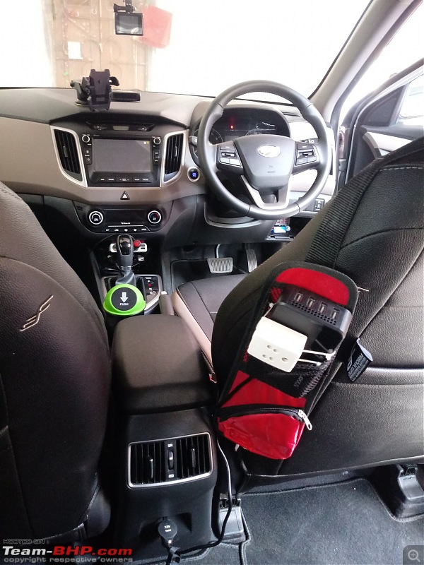

My 2017 first-generation prefacelifted 1.6 petrol AT Creta did not have any TPMS by default. However, we added a cheap aftermarket direct solar TPMS with external sensors for around INR 1100 from Aliexpress in 2018. We deliberately chose external sensors because we didn't want to deal with the hassles of the internal sensors. Internal sensors are very susceptible to damage especially on bad roads and replacing their batteries is also a major hassle. As far as maintenance goes, we have had to replace the batteries in the 4 external sensors only once to date.
The monitor unit of the TPMS can be recharged both by solar as well as by micro-USB. It has both high and low user-settable alarms for both temperature and pressure. It is accurate up to the first place after the decimal and it works on low power Bluetooth technology. And despite its cheap price, it has been working flawlessly, touchwood :)
