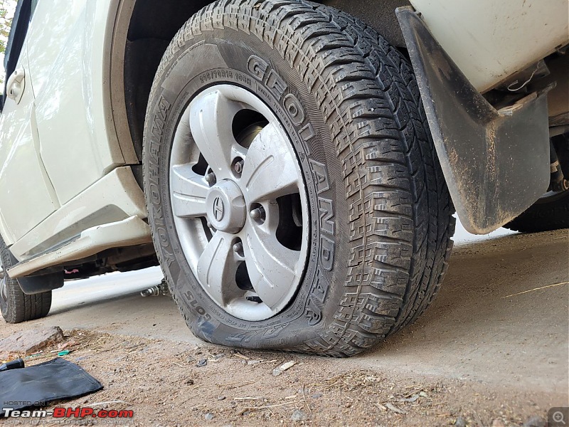

Have indirect TPMS and hate it. It only detects a difference in tyre pressure at speeds above 60-70 kmph. The last time I had a flat tyre at crawling speeds, it didn't even alert me. There is no substitute to proper TPMS, having the accurate PSI readings is also such a boon.
This happened at low city speeds. My TPMS thought "all is well", not even a warning:
