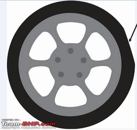

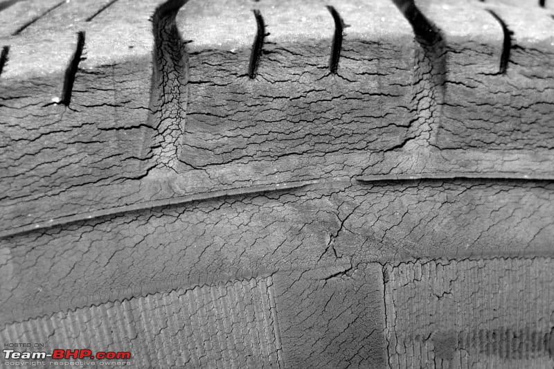

Originally Posted by RubberGuru1113 (Post 5402585)
Check for weathering cracks on the sidewall and tread portion. Also, a rarely used car would have been left standing for months together and if not moved regularly, the tyre might have developed flat spots (small patches of 10-12 cm on the tread where the natural circular shape has flattened out) where the circular shape has in the region where it was in contact with the ground. Have somebody move the vehicle slightly and check different regions of all 4 tyres to make sure it isn’t the case. If both tests pass, use the tyres for another year max and then have them replaced.
Attaching a reference image so you get an idea -
Flat spot -
Attachment 2358621
Weathering crack -
Attachment 2358622
