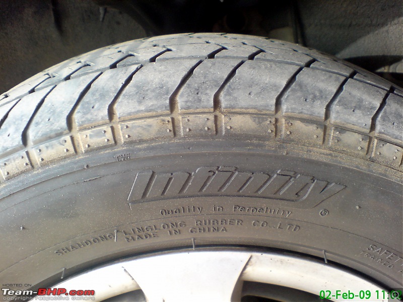

Got this set of 4 Infinity tubeless tyres for my Accent some 32,000 km ago (175/70-R13). China-made. Pic below. Please don't roll your eyes already. I did that too when a friend and tyre-shop owner insisted I try them out for free before paying him. So he gave me a set and I got hooked. The grip was fantastic, the ride much softer than the OE Bridgestones I changed over from, and car control was great. Initially scared of building up speed on them, I gradually came to realise these tyres don't run hot; have done 140+ km/h speeds continuously on these on the NE-1. Finally I paid my friend peanuts for the set (Rs.1400 each).
Before setting off for my last big trip (5000 km) I had HMP Delhi check alignment and balance during service. Useless guys didn't check rear wheel alignment apparently, and the rear left tyre lost a lot of rubber, to the point of exposing cords (see pic). Checked alignment today, 5.8 degrees out on the left rear wheel. Going to chew HMP Customer Service Manager's head off tomorrow.
So I effectively lost two tyres after using them for 32,000 km without a single puncture, over pretty bad roads at times - changed over to new tyres in the front. Infinity not available, so Bridgestones it is again.

@SS_Traveller,
The wear does not seems to be even. It looks more like someone scraped that particular area off. If there was an alignment issue, there would be an evenly uneven wear, isn't it? But here, this is just limited to one particular spot.

Originally Posted by HappyWheels View Post
@SS_Traveller,
There were a few more of those bald patches on the tread, but none as severe as the one in the pic. Only 3 reasons I know why such a bald patch pattern of wear can occur:
1. Wheel bearing failure - in my case, the bearing was opened and checked visually evn though it was running smoothly. No problem there.
2. Severe misalignment of wheels - 5.8 degrees offset is like the tyre wanting to go north-west while the car wants to go north. I had that problem, and the HMP people never detected it.
3. The driver stood up on his brake pedal and locked the wheel at high speed, scraping off the rubber at the contact patch. Happens to front tyre while mine was a rear tyre.
My vote is for this.
Sorry, but such a thing didn't happen to this tyre. I've not locked up my brakes and skidded at high speeds to cause this.

Infractions: 0/1 (7)
That spot doesn't look like it came from bad alignment or anything. It looks like a single scrape, like flatspotting, or someone literally took a file and ground off a bit of your tyre. Logic dictates that any rotational wear, such as through misalignment, will be more uniform.

SS-Traveller's Avatar
Join Date: Jan 2009
Posts: 8,283
Thanked: 28,776 Times
The kind of flat-spotting, that I speak about / probable reason behind your tyre damage, takes place when you brake:
- from a reasonable speed in a non-ABS car
- Tyre locks in place but the car is still skidding forward.
- You'll see a lot of tyre smoke (smell to die for ) in most cases.
Hi GTO, I have been trying to clarify that the tyre in question has NOT locked and skidded to cause the damage as shown in the picture. I am 100% sure of this because I am the only person who drives this car. Ever. Neither has this axle got any broken bearings (I had the hub opened up and checked even though there was no bearing noise).
Therefore the only explanation that is feasible by elimination is that this has been caused by a major misalignment, as was discovered - a 5.8 degree toe-in of the rear left wheel. This was corrected. If you notice, the outer (upper) edge of the tread has also worn away badly, so wheel misalignment seems to be the culprit.
If any member knows of any other reason that may have caused this (apart from skidding a locked wheel at speed, broken bearing and misalignment), I would like to know so such a fault can be corrected. This the rear left wheel of a FWD Accent Viva CRDi, and the tyre wore out in the last 5000 km.

Posts: 5,365
Thanked: 7,507 Times
SS-traveller, we are trying to point out that there is no way a misalignment can create a single flatspot. Also, if you notice, some of the dirt marks to the right of the exposed metal run perpendicular to the direction of rotation, which would indicate someone actually grinding rubber off the tyre.
