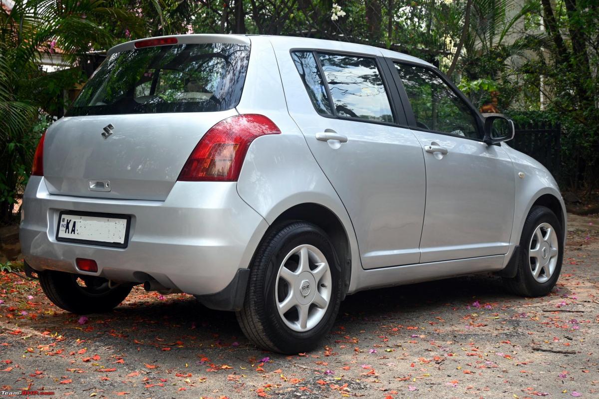

Enclosing some pics of the car post work.
