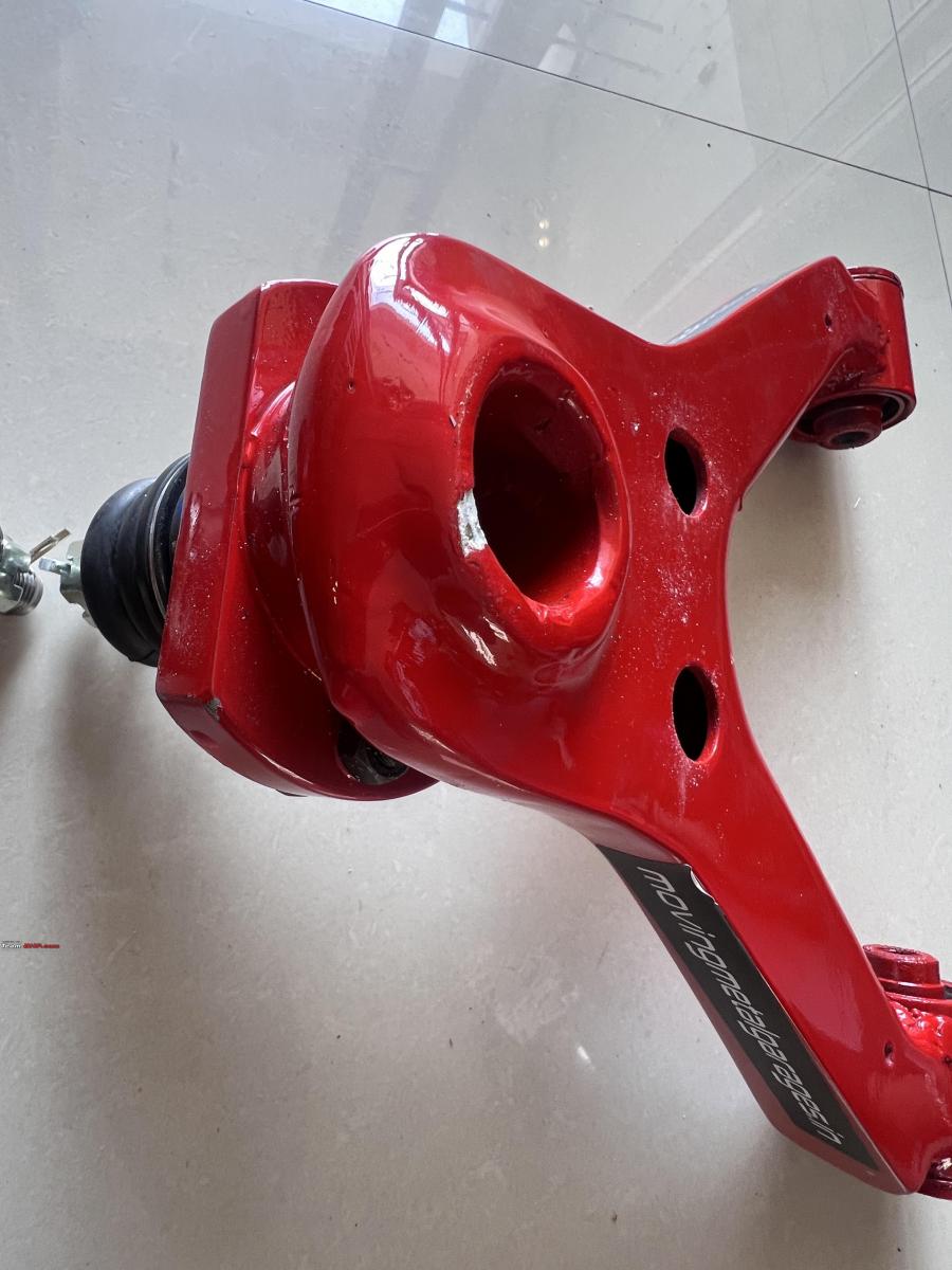

  • Front Heavy Duty Upper Control Arms - 2

Front Heavy Duty Control Arms:

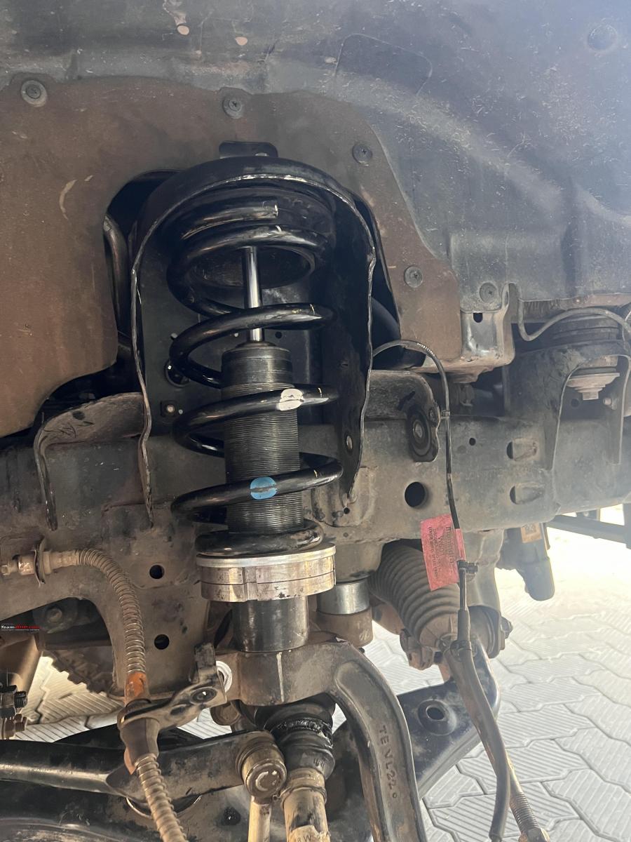

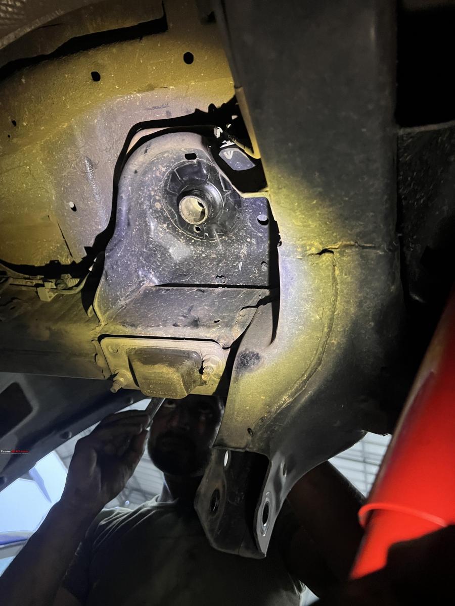

Removed under body protection plate and removed the front suspension.
It was pretty difficult to remove the suspension itself. Especially, to take out J shaped arm from the lower control arm. Once that is done the suspension comes out.

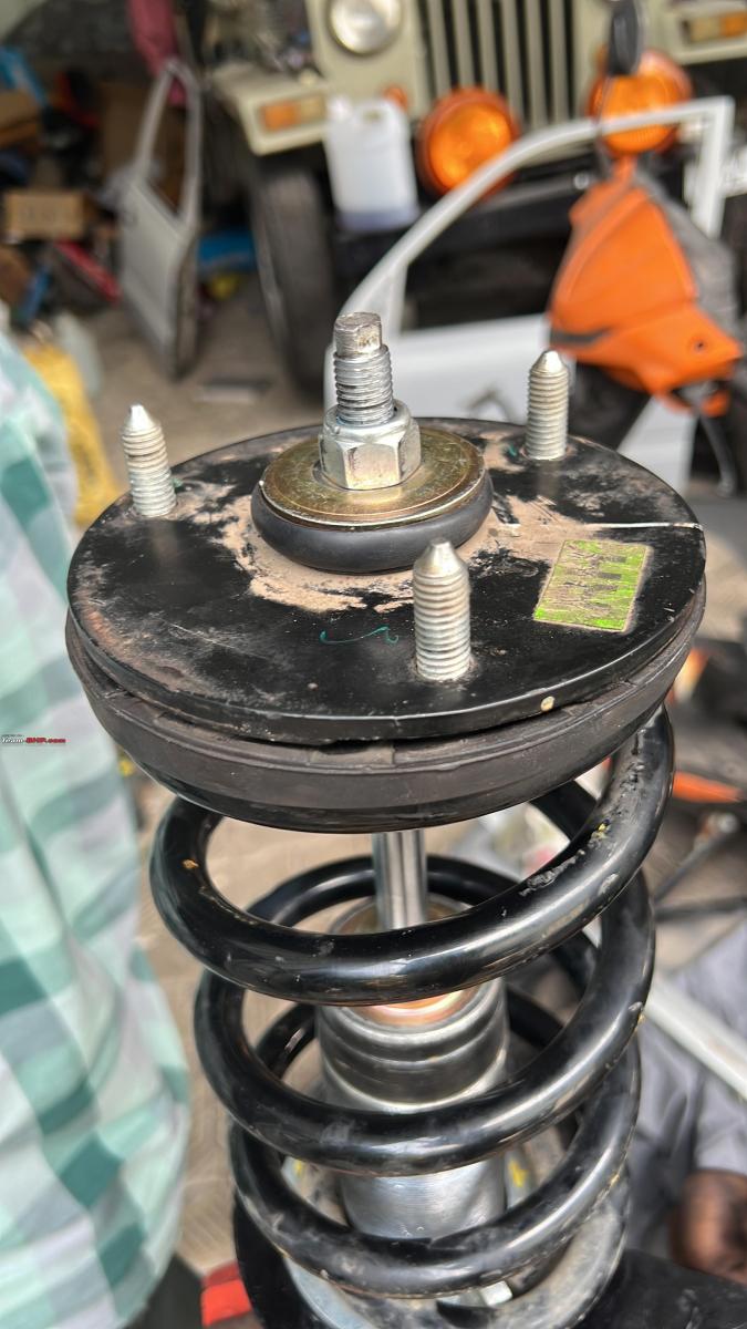

The next step is to take out the stock springs with the help of spring compressor tool. Top Spring seat and Spring seat rubber are to be used.

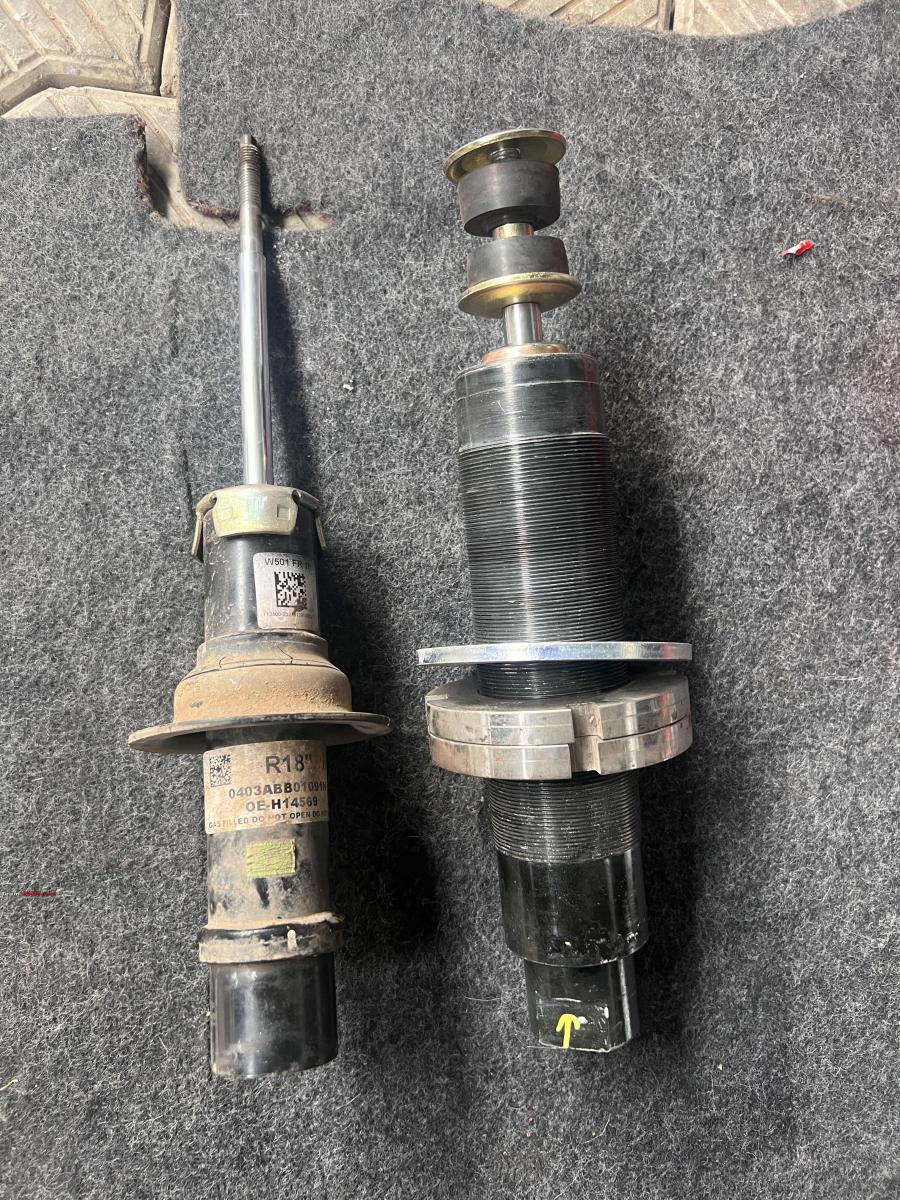

MMG shocks come with washer and rubber bushes. Hence stock glass type washer and bushes are not to be used.
Stock Shocks Vs MMG Shocks:
Once the springs are out, this needs to be mounted on MMG shocks in a similar fashion and the height of the shocks need to be adjusted with the tool provided. I have set it to 155mm as I have a winch.

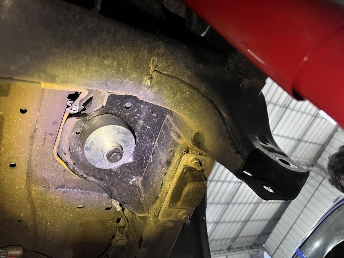

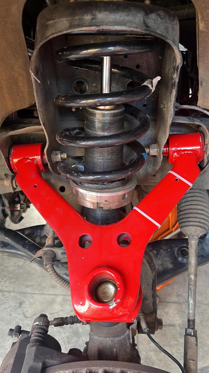

Fit back the front shocks and install the MMG upper control arms.
Stock Upper Control Arm Vs MMG Heavy Duty Control Arm:
Once everything is back in place, need to check if upper control arms are touching the springs, if so the spring seating needs to be corrected. Springs should sit as it was sitting in stock set up.

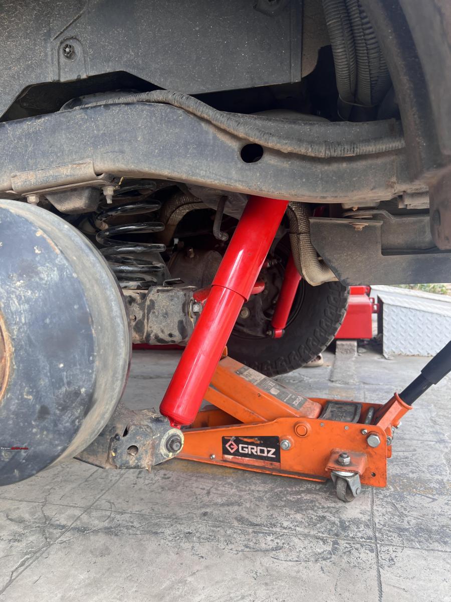

Once the front was done, we moved to back. Rear shockers are direct fit which was also a fairly easy job.
