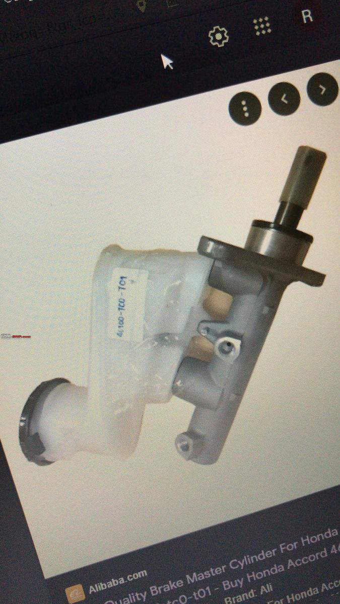

Its been months now that I have been facing this peculiar issue : The brake comes into effect only when the brake pedal is pressed sufficiently. For example, for the initial press of the 'Brake pedal' , nothing happens. Lets say, that the 'brake pedal travel' is being measured on a scale of 1-10. For the initial '1-4' brake press , nothing happens. Brake comes into effect between '5-10' on the scale. I keep on topping up 'Brake fluid reservoir'. Initially, I went to the same workshop which recently attempted the part replacement (WoS, Noida). There the mechanic and SA mentioned 'Brake Master Cylinder' being the culprit. I got the same diagnosis from another workshop. I have checked some YouTube videos and they confirm the fact that its the 'Brake Master Cylinder'. Therefore, when I went to the independent workshop , I had procured the AFM Brake Master Cylinder. However, what can we do if the originally one is stuck and wont come out?

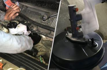

So, finally, day before yesterday, took some time to get the car to the repair shop in order to get the pending replacement job done. The OEM brake booster, brake master cylinder, and OEM Dot-3 brake fluid had arrived and been lying dust at my home. The job of detaching the old brake master cylinder from brake booster and getting brake booster out from the engine bay in itself required two to three hours. There wasn't enough space to get the brake booster out, the mechanic had to get the AC line out which lead to the release of any existing AC gas in the system, the strut bar had to be removed, we didn't remove the power steering hose as stated by fellow Bhpian 'vigsom'. However his advice was really helpful in terms of getting the job done.
Once the old parts were out, getting the new brake booster installed was time consuming. The replacement job started at 1145 and by 4 PM we had the old parts out and the new brake booster installed. Then the new brake master cylinder was installed and filled with OEM brake fluid. The peripheral parts taken out to get the space required for the brake booster were re-installed, AC gas refilled, then started the final phase of brake bleeding and test drove the vehicle to check everything was in order.
