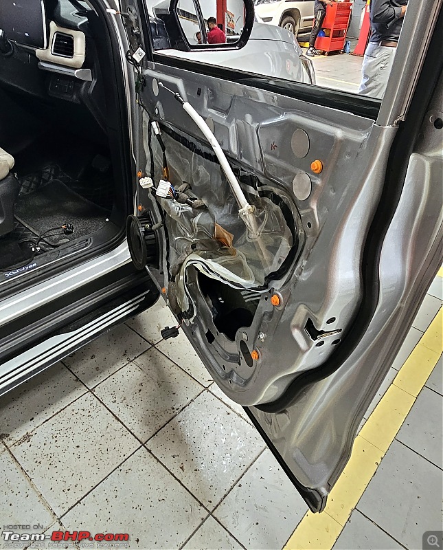

Due to a planned journey, got the 60K service done slightly early at 59,773 Kms even before the service reminder came up which had to be manually cleared on the drive later on. There was a huge rush that day due to the workshop being closed for almost a week due to Kanwar yatra but the service took no time as usual. What took time was the service action for updating the software for the driver-side power window motor which requires the inner door panel to be removed. Skipped the washing to save time and I was back on the road in just under 3 hours.

The naked door for the service action of software update

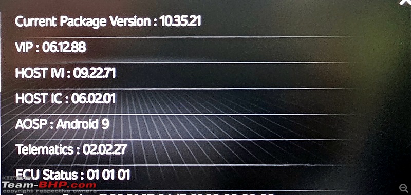

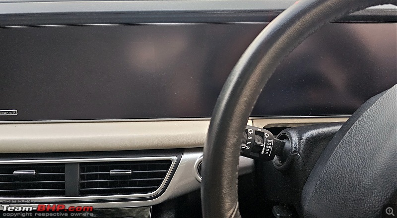

Upon turning ON the ignition to leave for home at night, for the first time got a notification for an OTA update. Since I didn’t have time for the update which usually takes 30 mins via USB at the workshop, I postponed the installation for the next day. After checking the in-built network had a strong signal, I started the process at 6:41 PM and immediately both the screens went blank only to be greeted by some notification 2 minutes later. The process took 20 minutes and everything came back to life at exactly 7:02 PM
OTA notification
Information after accepting the update
6:41 PM
6:43 PM
Update in progress
Before version
After version

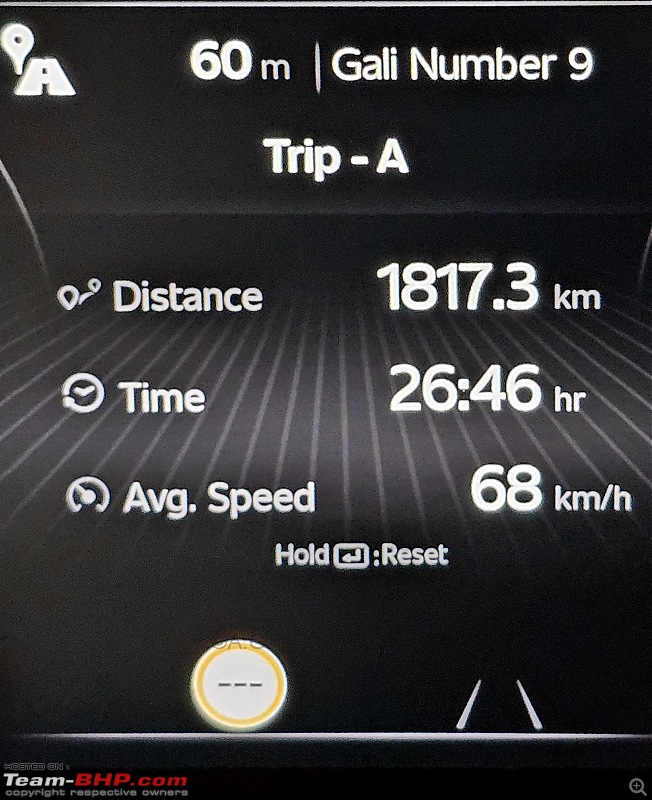

The final trip stats
Kashi – this trip was planned long ago and because of this, the service done slightly early. While going we went via Kanpur but on the return journey, we changed the plan once again and went to Ayodhya, this time for the evening aarti. The trip back to Delhi was mostly via Expressway and we were astonished with the FE with cruise set at 10 above the limit.
FE of 16.2 over 652 Kms (600 Kms on Expressway
Final trip stats
